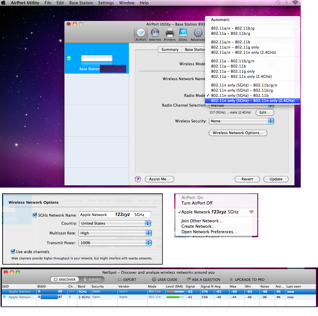

I have all 5 GHz equipment & want to configure the Extreme to use only 5 GHz band --
As you can see in the attached screencap, I do NOT have an option to use 802.11n 5 GHz ONLY !
I'm just a beginner, but when I run NetSpot, it shows both 2.43 & 5 GHz being transmitted --
even after I've checked the 5 GHz box under "Wireless Network Options".
I would greatly appreciate some help to understand this - in other posts,
I've seen people's screencaps of the "Radio Mode" button that clearly showed a 5 GHz ONLY choice --
of course, I get all these Options by pressing the Option key before L-clicking the choicebox.
Thank you --

See if you can give the 5Ghz WiFi a different name to the 2.4Ghz WiFi. You should be able to through Wireless>Wireless Options.
Then ONLY set the 5Ghz name as the preferred network in all your devices' WiFi settings.
@drsox - I did that, but still getting the report from NetSpot that 2.4 GHz is transmitting - plus,
(as so many discover about the greater strength of 2.4 vs. 5 in going thru obstructions) it's stronger !!

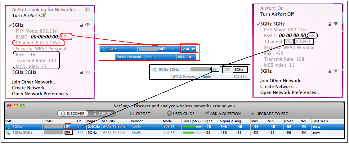

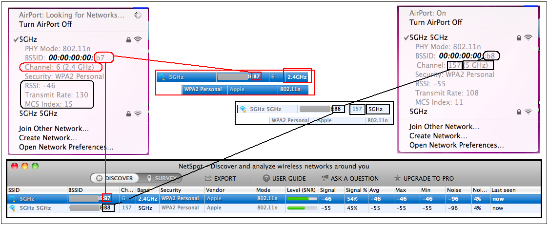

well, i made some fun discoveries this afternoon,
just gonna post quick about them because i need to study more
to actually understand them, but here they are :
1st, the screenie evidence:
This shows several things -- 1st, press the Option key,
then Lclick the Airport icon in the Title Bar to get the extended menu.
Now notice that the network I'd simply labeled as "5GHz" in top left corner,
is communicating on the 2.4 GHz radio/band on Channel 6;
while the labeled "5GHz 5GHz" on the right
is communicating on the 5 GHz radio/band on Channel 157.
Next, and VERY IMPORTANT ! :
notice how each radio/band has its own BSSID !!!
Obviously I've covered over the bulk of my numbers -
but the point is that they are the exact same numbers except for the very last digit - b7 / b8 !!
This should mean that once you've discovered the unique BSSID
associated w/ either the 2.4 radio/band or the 5 GHz radio/band,
then hopefully we can use that to directly specify the radio/band
that we want our network or devices to use.
Understand that the BSSID = the MAC address of the radio/band

-- a reminder that i'm using a 3rd generation A1301 simultaneous dual-band (dual-radio) Airport Extreme.
