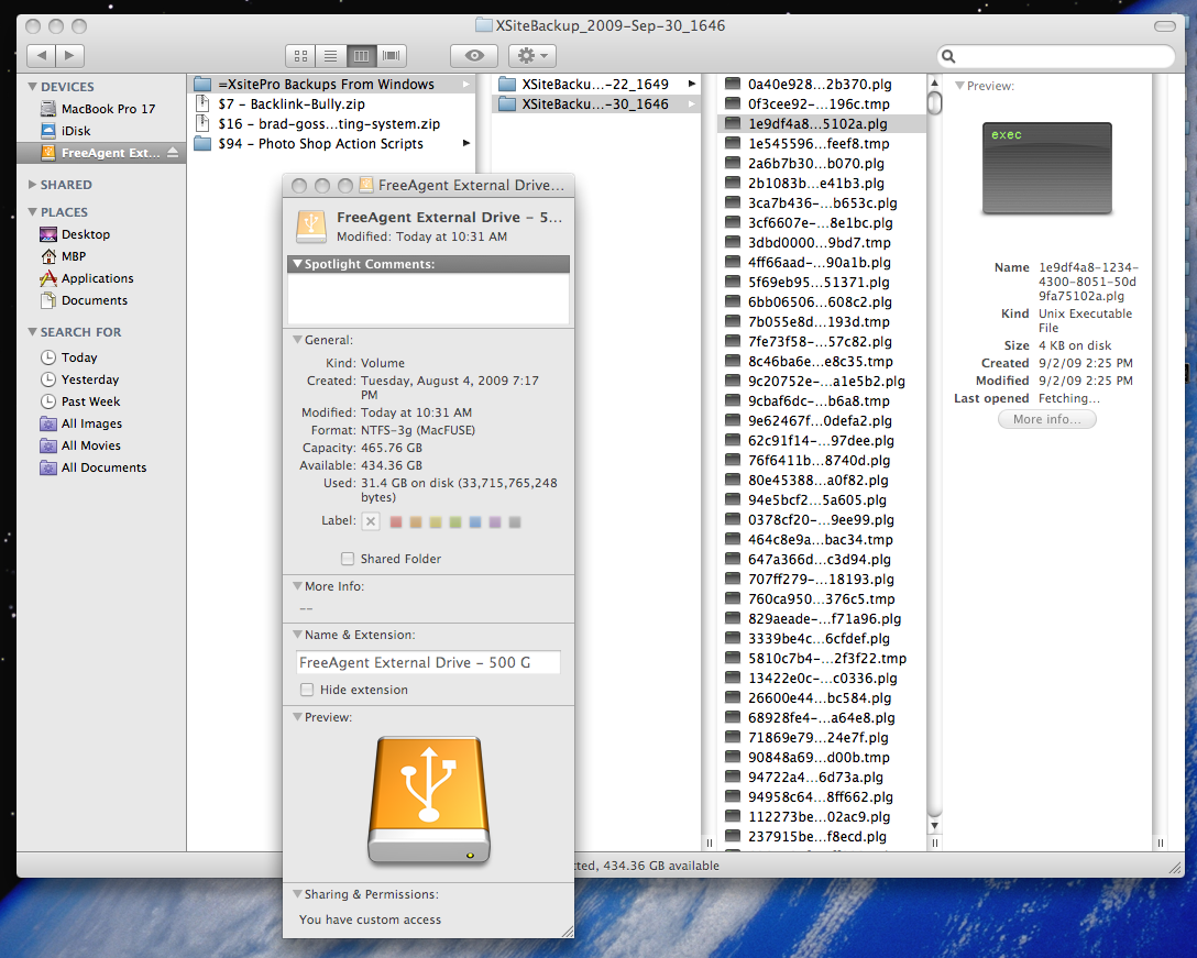

I attached a screenshot of the open hard drive showing only 4 visible files and it also shows the 'Get Info' box which shows that the hard drive actually has 31.4 GB of files but I can only see 4 files that comprise 2 GB. Those 4 files were obviously added AFTER all the other files disappeared on me.
I run VM Ware Fusion with XP Pro on this Mac and the other weird thing is that my backup files for a program called XsitePro2 are being saved as Unix Executable Files and they aren't saved as exe files when I look at the backup files on the Windows XP side. This is a separate issue (and maybe its a non-issue), but do you know why they are being saved like this?

"Unix Executable Files" have nothing whatsoever to do with .exe files. Unix applications have no .something extension associated with them. On the Mac, any file marked as "executable" (that's a specific unix permission) that doesn't have a recognized file type will default to this.
Files off a filesystem that doesn't handle unix permissions (meaning FAT or NTFS, for the most part) will default to execute permissions, so if they don't have a recognized extension (.jpg or whatever), they'll end up looking like that in the Finder. Which is your situation--you can see that the file still has the expected .plg extension, the Finder just has no idea what that means.
Bottom line, it's completely normal and the expected behavior.
