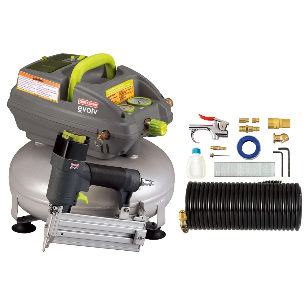

I wanted something inexpensive, suitable for homeowner use. I gave up on the battery powered one. I all most jumped on this ($80) but its reviews were bad:
Sears Evolv Combo
00915206000
But then I settled for this, because of the higher capacity, higher horsepower compressor, and better reviews although it's more than twice as much. But that motto you get what you pay for hopefully applies 🙂 :
Hitachi Combo ($220)

I think you're on the right track with a not-too-expensive pancake compressor kit like you've pictured. Don't buy the $50 Walmart or Harbor Freight special, but as you've discovered, going cordless properly isn't going to be cheap either.
The major advantage of a cordless nailgun is the fact that it's cordless (duh) which is useful if you're up on a rooftop or in an area where there's no power to run the compressor. It's also a little less hassle to take around because you don't also need to lug around the compressor, the hose, the electrical cable, etc.
However, you pay for those conveniences. You need to pay for consumable gas cartridges for the Paslode, or lug around batteries for electric units. These mechanisms cost a lot more and the whole unit is going to be much heavier as a result. The electric ones like the DeWalt are also slower to fire because they need to spin up a flywheel each time. And cordless units might not have the "oomph" to fully insert the fastener, especially if it's a longer fastener into a harder wood such as oak.
The compressor kit will be much better value and more versatile in the long run. In addition to the nailer it comes with, you can buy other nailers and staplers, as well as inflators for your car tires, beach balls, air mattresses, etc, and all kinds of other fun tools.

I agree with your points. Batteries are expensive and the battery is just something else that can deteriorate. I believe the air driven mechanisms are simpler proven technology that will hold up better if it is sitting a year between uses.
After reading bad reviews on the $80 Sears model, as in, "the gun is a piece of junk", I decided to spend twice as much on the Hitachi model. I've installed several rooms of 6" baseboard molding in the past and when I started my project yesterday with the pre-drill, the accidental hammer marks on the molding, the nails that start bending half way in, and sinking them, I said enough and purchased the Hitachi unit. What irritates me is that I can't find this unit locally. It had to be ordered online so I'll see it the beginning of next week.
