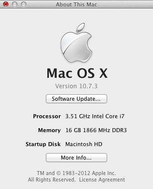

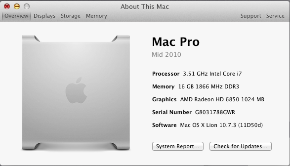

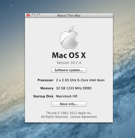

All you folks who have upgraded your MacPros to some "non-standard" config, how bout posting your "About This Mac"...
I'll start with my 1,1...

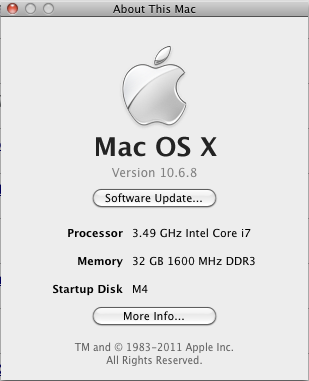

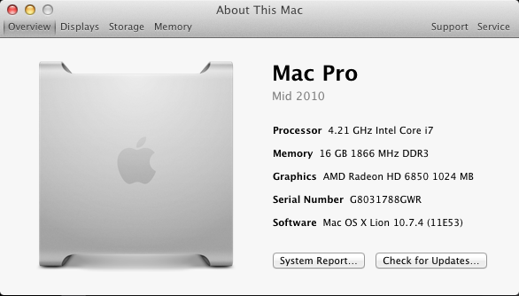

A little while ago I Frankensteined my quad core 1,1 Mac Pro into an octo core. Scary stuff (at least for me) but worked out well. I wrote about the experience on my blog: http://bartkowalski.com/2010/11/octocore/
I'm itching for a new Mac Pro as are many others. I've been *this* close to pulling the trigger on a hex 3.33 over the last few months. I keep telling myself the update is coming, the update is coming…

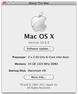

I got the 2010 Mac Pro (hex model with 6 GBs of RAM)
Since then I have added a 3 TB HD, 240 GB OWC SSD, and removed the 6 GBs of RAM and put in 3 x 8 GBs of ECC RAM.
Was playing with Apple logo colors... settled on green, since I love green apples. I was going for a Granny Smith green. 🙂

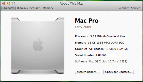

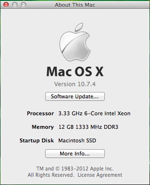

I posted this in another thread, but my 2010 was originally a 2 x 2.4GHz e5620 and was upgraded to a 2 x 3.46GHz x5690 system.
For storage, I have 5 drives in the machine. One SSD in the 5.25" bay under the BD-ROM drive, 2 1TB 7200RPM drives mirrored together in drive bays 1 and 2, and 2 300GB 10000RPM drives striped together in drive bays 3 and 4.
jas
how did you upgrade the cpu on the 2009? i read that the 2009 8 core has lidless cpu's thus making it impossible to switch them out to 6core cup's.
It's not impossible, just really tricky and not for the faint of heart as I understand it. You can do one of a few things, from what I know:
  • Try to pry the lids off the new Intel chips (eek!)
  • Attach the heat sinks without tightening the screws down much at all
  • Attach the heat sinks with different screws and washers to give the heat sink enough room to clear the lid and not crush the chip pins.
jas
jas
which of the 3 methods above did you go with?
I went to a hardware store with my digital caliper. I needed washers that would provide about 2.3mm increase in height. I used 16 1.16mm stainless steel washers. I also had to remove the retaining clips from the heatsink fan with flush cut clippers to allow the fan connector to make a connection. All has worked well for 6 or 7 months. Existing screws were reused.
