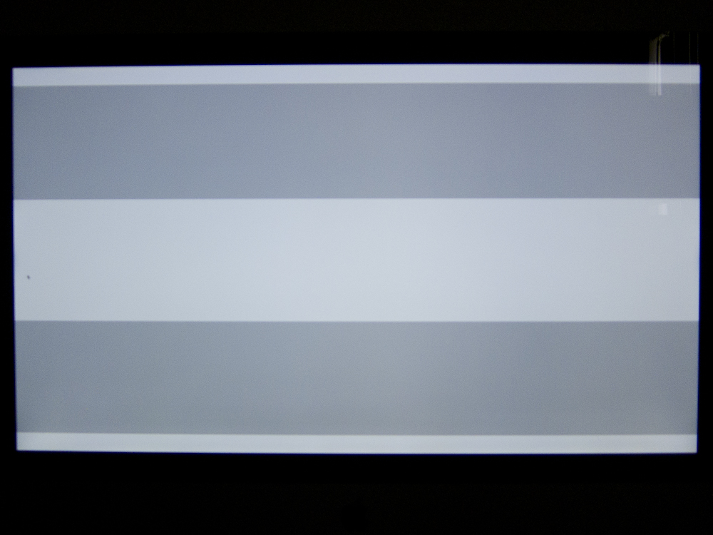

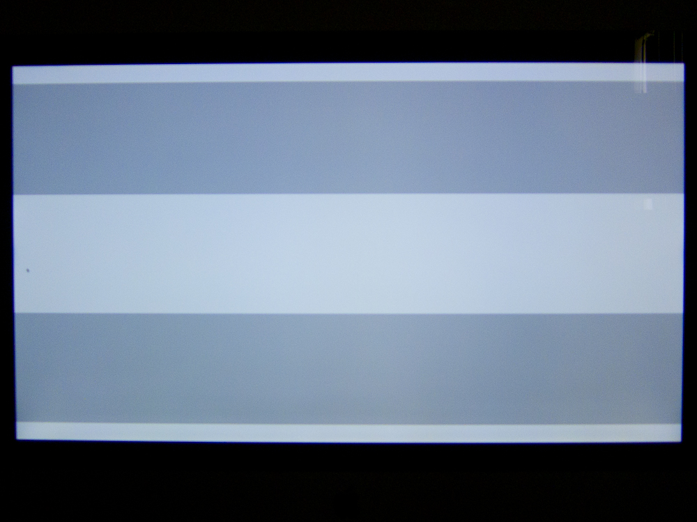

Those are cropped photos from a screen test taken with the same white balance settings on my dSLR. In other words, the greys and whites should match. Clearly, they don't.
from Gizmodo

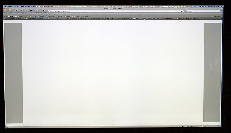

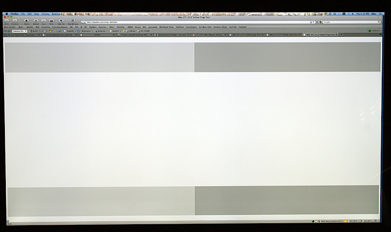

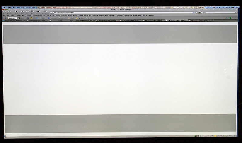

Test Instructions:
Go to the link below with the height and width of your window maximized,
[link no longer works]
  1. While focussing your eyes on the grey bars at the bottom
  2. Resize the height of your browser window so that the grey boxes are almost touching
  3. Resize the browser back to full size
  4. Repeat steps 1-3 several times. Do the test while you are looking directly at the screen, do not tilt your screen up or down. Align your eyes perpendicular to the screen.
Note: Your screen may have the yellow tinge on a corner as opposed to the entire bottom.
The following links might be useful to help you look for them.
Top vs Bottom grey bars (single color)
Left vs Right grey bars
Confirm whether or not the two bars look indistinguishable in color during the entire test. There maybe slight variability in LCDs, but there should not be a significant color shift. Most of the displays with the issue have a noticeable much warmer (yellowing) tone towards 1/3 bottom of the screen, as illustrated in the photos below:
Tip: The grey bars will look identical in color when they are close together (near the top of the screen). The yellowing issue starts from the middle towards the bottom of the screen.
Tip: The issue will appear to be more severe and more apparent in dark room conditions (preferably with all lights off). It will also be much more apparent if you lower the brightness. Try doing both if you are not sure whether your display has the problem. Do try to play with ambient lighting conditions, sometimes in a very bright environment the yellow tinge is much more subtle.
Warning: Do Not Tilt the Angle. If you do tilt the screen upwards, the yellow will fade — BUT as this happens, the top of the screen turns Purple, which will be more difficult to notice in grey. Anyway, nobody should be using their iMac in such a way. If you are doing the test, try to align your eyes normally.
Note: Other forms of color uniformity issues maybe present. There are reports of honeycomb yellowing patterns, yellow band that run horizontally, yellow band that run vertically, and or significant splotches of yellowing towards the lower left or right corner. These maybe developed from the same problem documented here.
Carefully observe the differences. While there are slight variability for LCDs, there should not be a significant color shift/cast. The color uniformity for LED IPS panels should be very acceptable.
After you have done the test, please vote in the poll.
Please keep in mind that this test was designed to make the "yellow tint" easier to spot. Making an unacceptable display easily identifiable. If you can't really tell after the test, chances are it is probably an acceptable display. If the display appears to be highly acceptable to you (in regards to color uniformity), though it might have a very mild color shift, there really isn't much to worry about so long as it does not affect your day to day usage. But do keep in mind that while your display might look acceptable in your eyes, it might not be the same for some others.
This poll applies to new iMacs only. Do not vote otherwise.
If your display shows identical colors after doing the test several times, it means that your display has no such issue. If you could list your week number for your iMac here it will help Apple track down units. If your display has other related issues, you can describe it below.

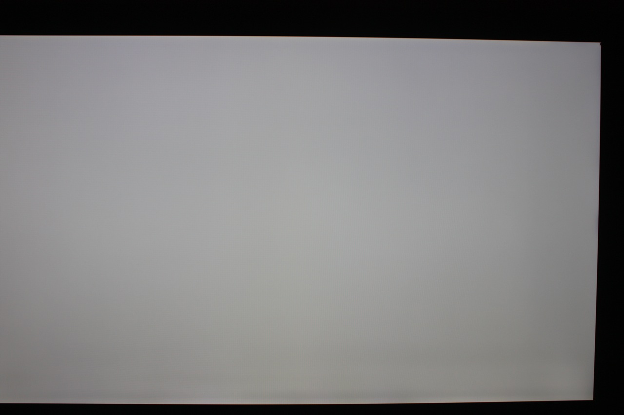

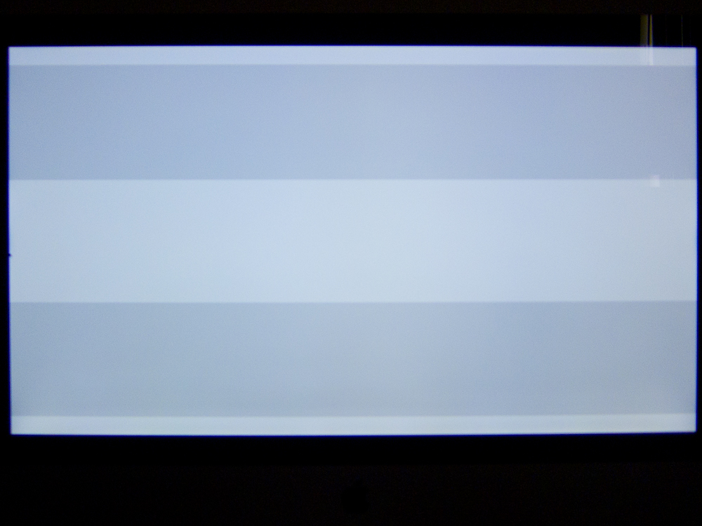

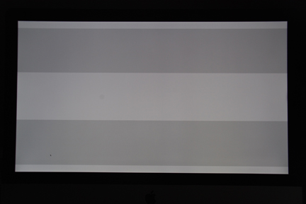

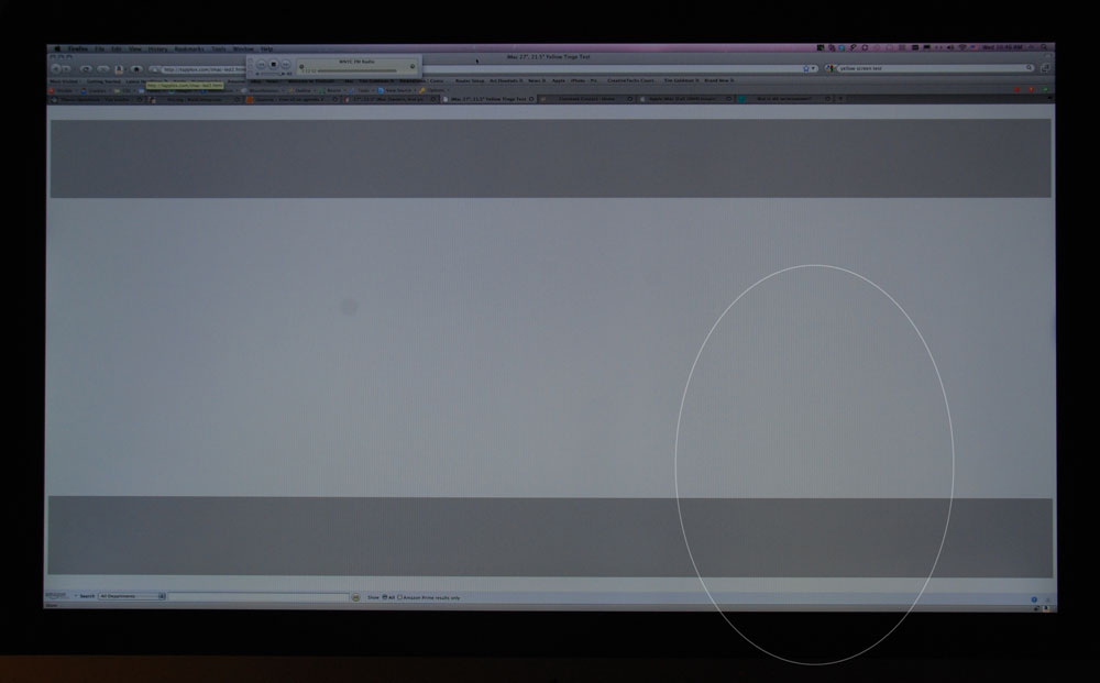

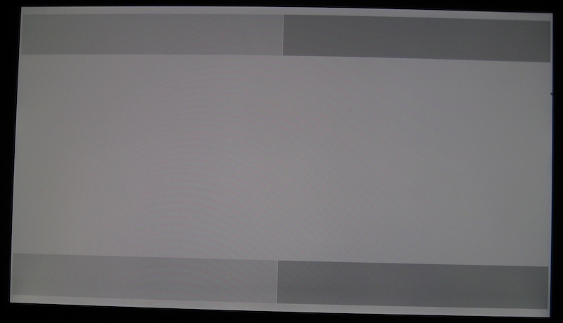

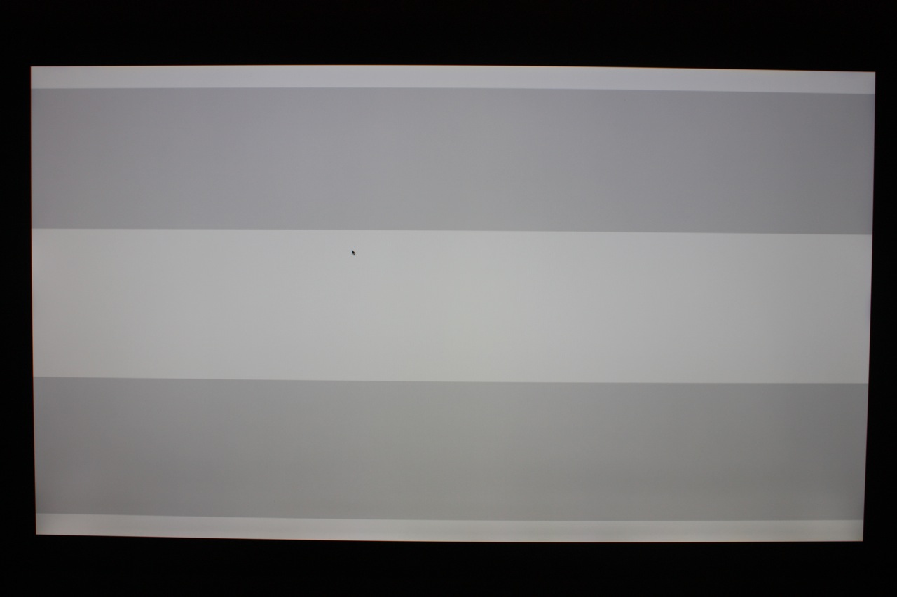

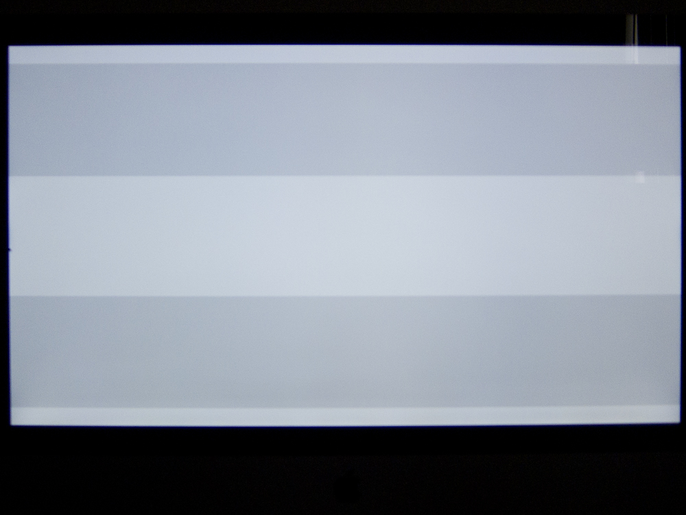

Yellow Tinge Photos

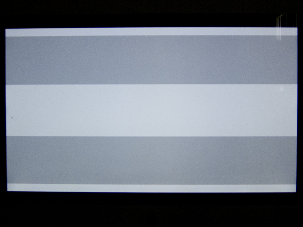

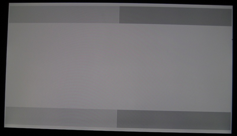

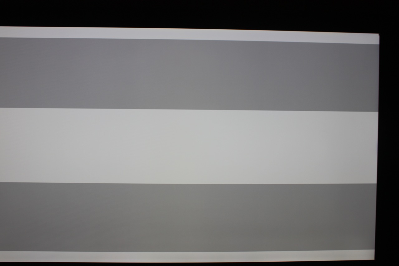

Yellow (left) vs Yellow-free (right) 27" iMacs. Photo courtesy of Mitch Aunger

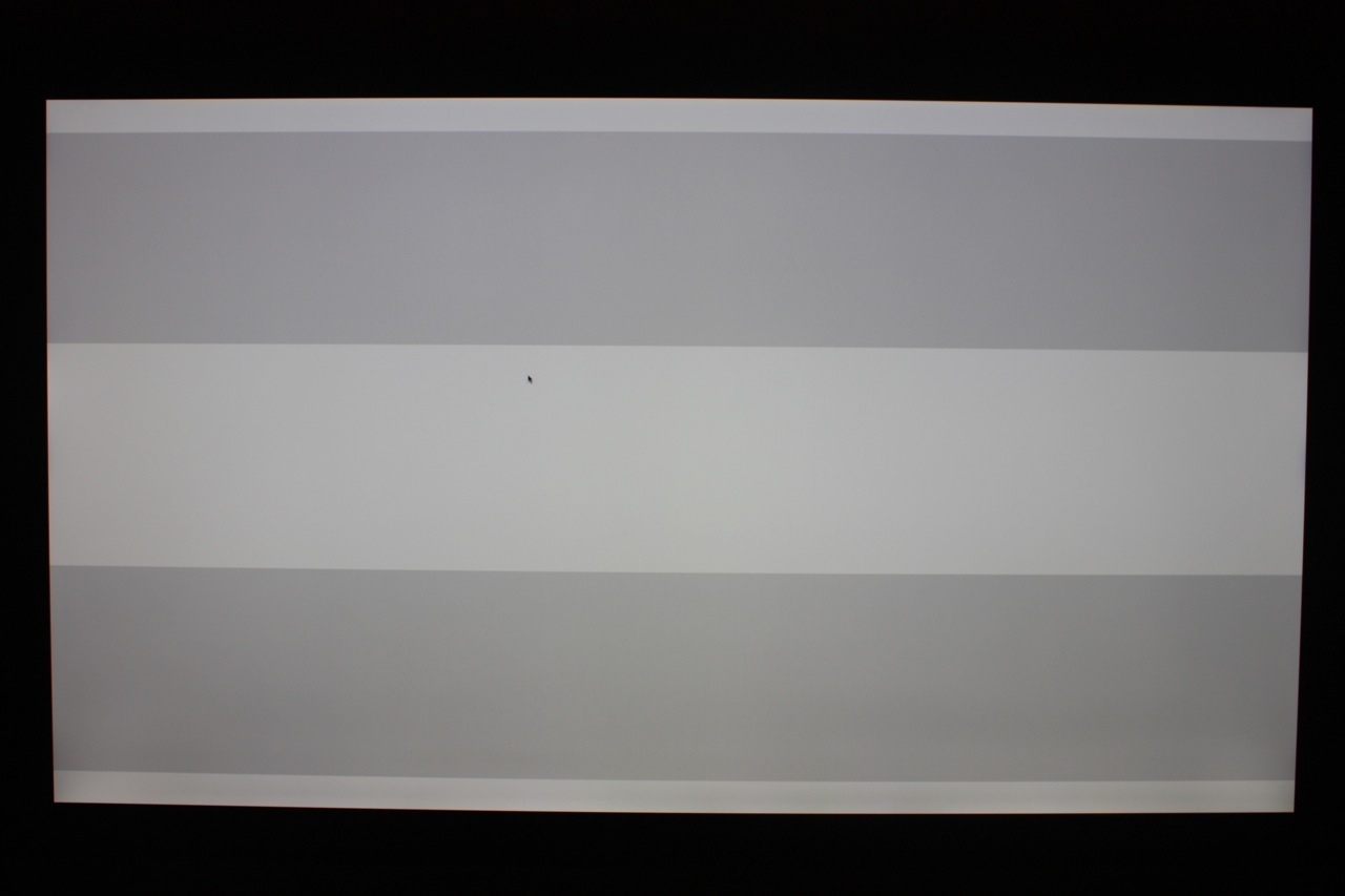

Greybars 100% brightness.
Yellow tinge bottom right (left), Yellow vertical stripe center (right). Photo courtesy of knewsom

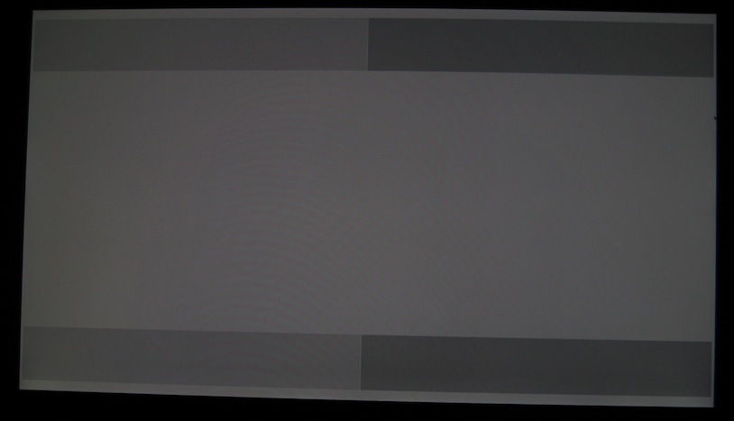

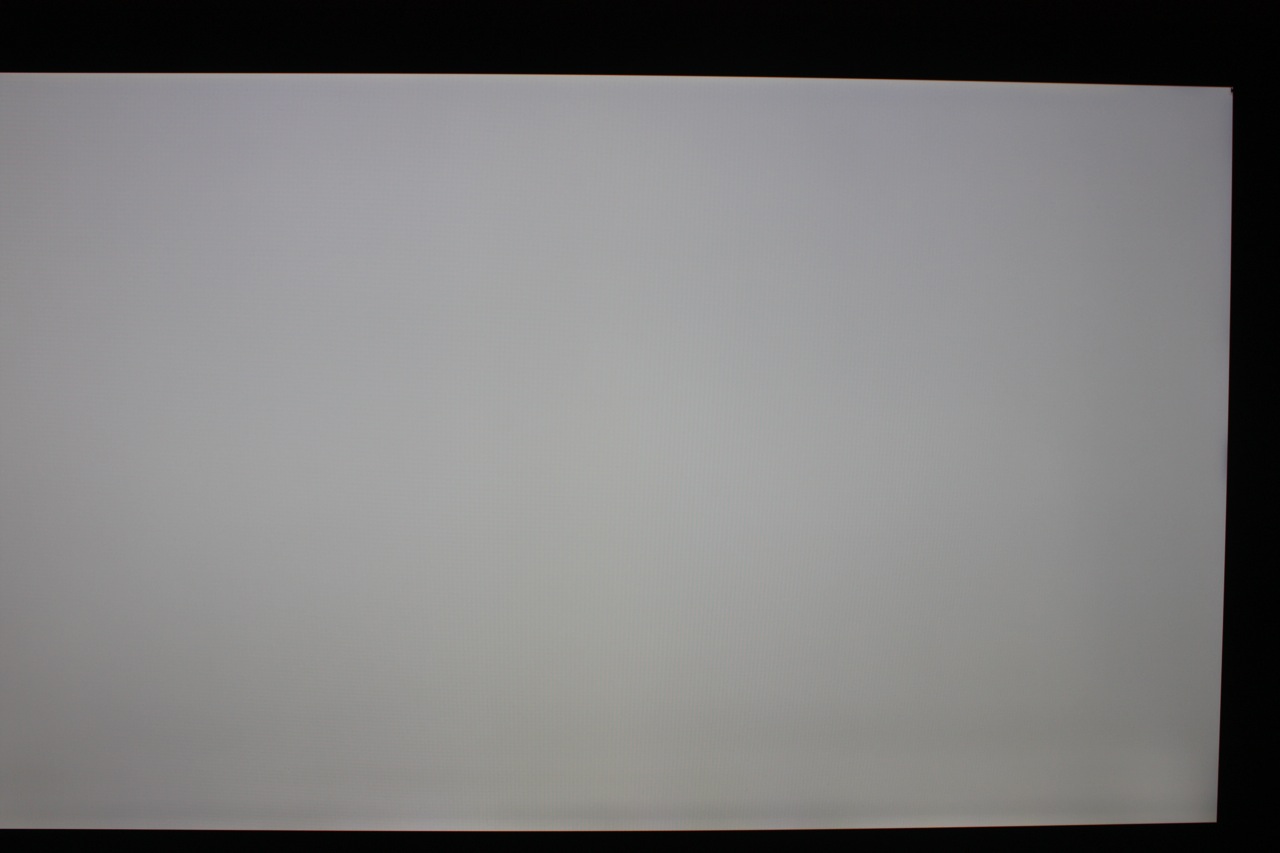

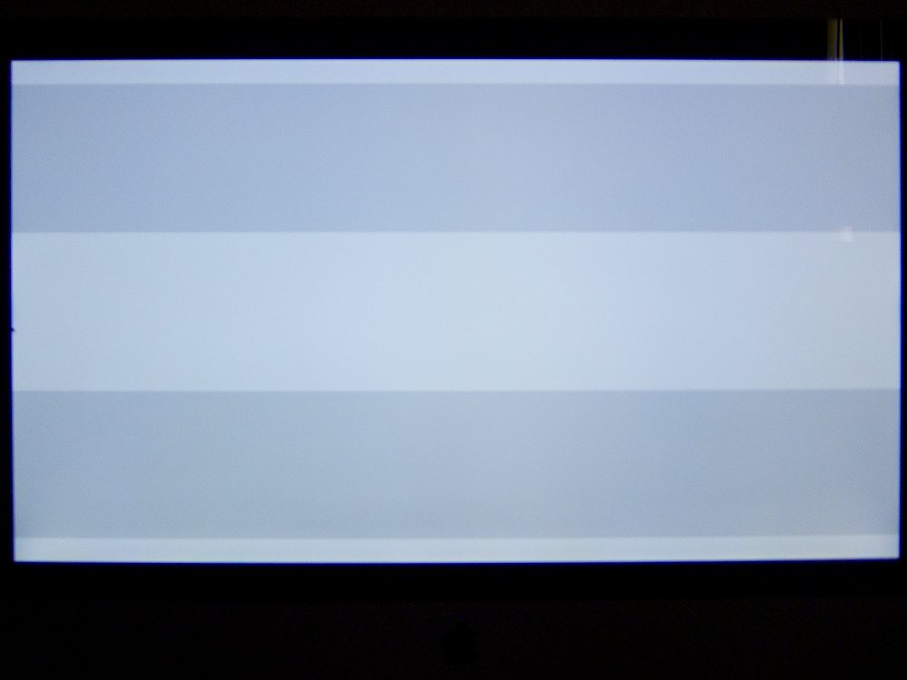

Finder (details view) test at 50% brightness.
Yellow tinge bottom right(left), Yellow vertical stripe center (right). Photo courtesy of knewsom

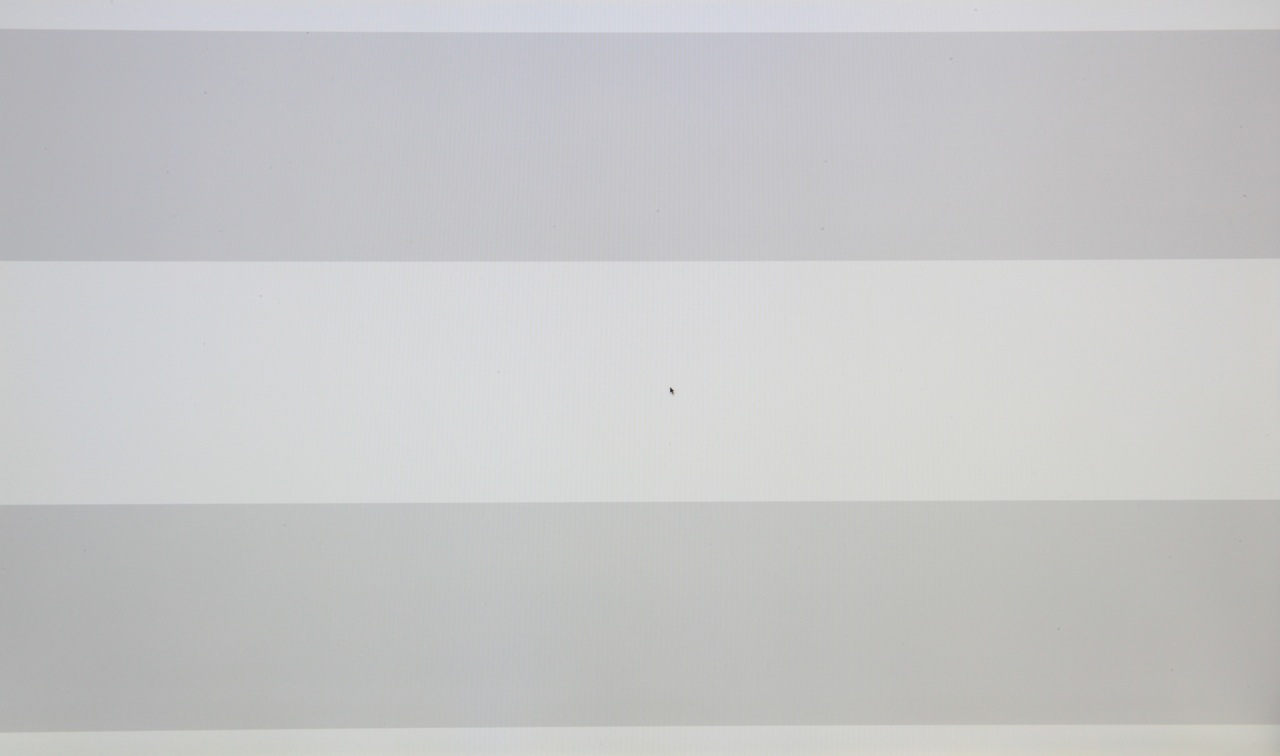

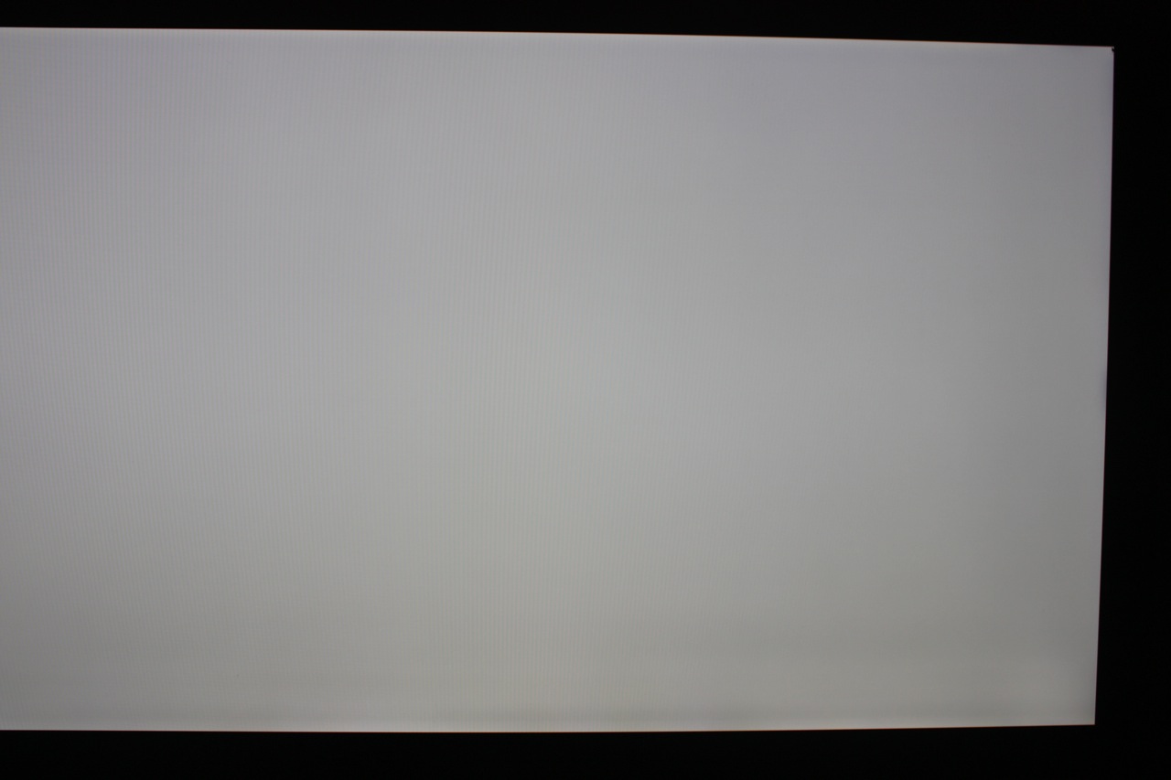

Finder (details view) test at 100% brightness.
Note carefully that, when compared to 50% brightness in the photo above, higher brightness levels tend to hide the yellowing slightly. Photo courtesy of knewsom

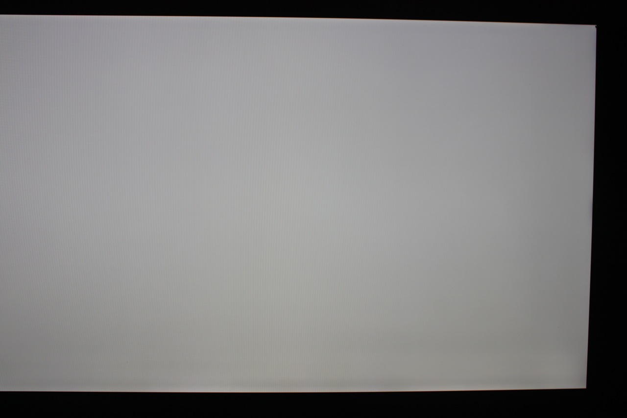

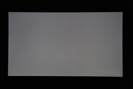

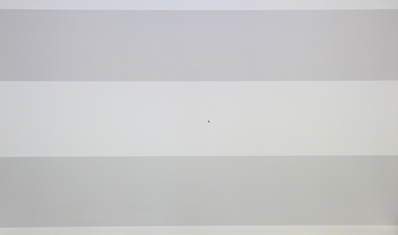

Non-Yellow uniform screen. Courtesy of robotkiller.

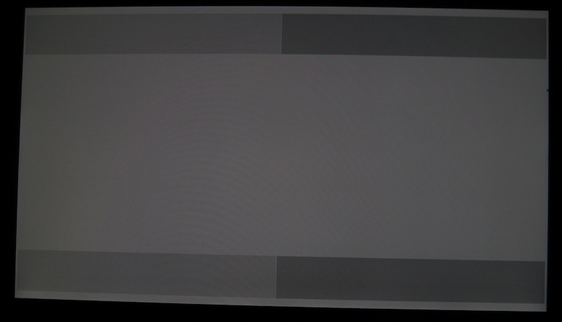

Yellow 1/3 Bottomon with White. Courtesy of Big iMac.

What is interesting are the backlights, look at the bottom right. It is white, where the other 3 have a more yellow look. This was a solid black background, in a dark room, with screen at full brightness
I'm struggling with this a bit, my wife is telling me to live with it. Nothing is perfect but I find it difficult knowing and seeing a problem. Someone else has advised keeping it till Apple have acknowledged the problem and starting rectifying it.
After the problems I had with the 24" LED display (bad backlight bleed, dead pixels, dust under the screen) I am not keen to go through the problems again.
[EDIT to remove linked pic from Twitpic and uploaded as an attachment]

After testing several different models in several different stores today, only one 27 inch iMac model showed acceptable white levels in the screen.
I tested 5 x 27" models, 2 x 13" macbooks, 3 x 21.5 inch imacs and 3 x 24 inch displays.
All had glossy screens and all of them, except the macbooks, exhibited some degree of yellow tinge in the screen.
I used tapplox's test HERE
