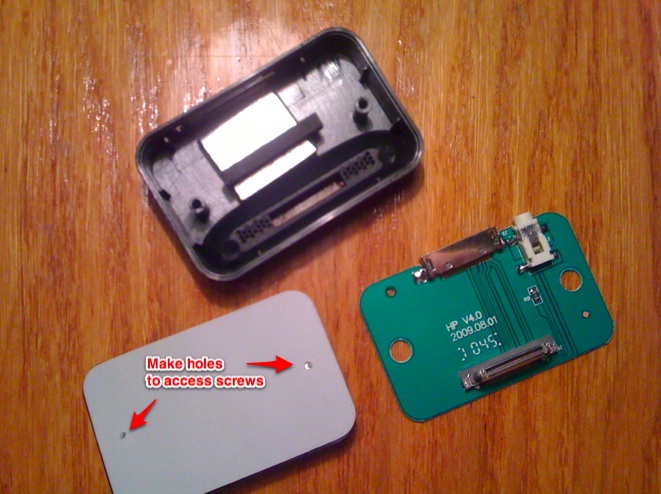

I recently bought cheap docking station for my iPhone 3G from Dealextreme and have exacly the same problem.
I've opened my dock:
and found one resistor inside, near line-out connector.
To disable line out function of the dock (and use internal iPhone speaker for music) you can desolder that resistor or just cut the lane leading to that resistor with sharp knife.

This works plugged and unplugged. But there is a better solution, than just cutting the lane. You can replace 3.5mm line-out connector with special one, with switch inside, and connect resistor through switch, so it will be connected only when 3.5 mm audio jack is inserted into line-out.

I got the same dock for 2.50 shipped. It was cheaply constructed. I desoldered the a9 resistor and now it plays audio

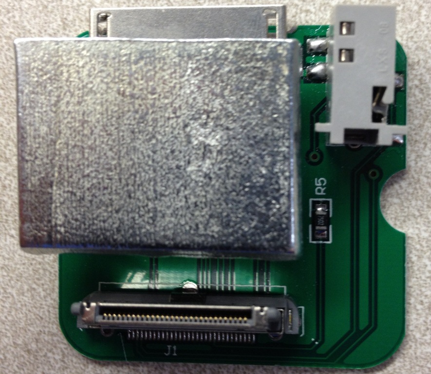

I'm hoping someone can assist me...I just bought a dock and have the same "only ringtones" play issue while docked. I opened up my dock and while the outside case is the same, the internals are just a bit different. I only know so much about internal electronics, is the R5 component the resistor that needs to be desoldered..(I thought I'd find a color band resistor). Or I can just use a blade to cut the two lines going down from it correct? Thanks everyone.

I have the same issue with these small charge docks, I've tried cutting the two lines to the resistor, but still no sound. Either I didn't cut deep enough or it just didn't work... Could anybody point out exactly what to do? I'm not very good with electronics, but I REALLY want the sound to work as it will make a nice alarm clock. Thanks.
