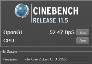

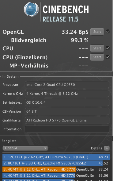

and would you mind showing as a fair comparison how far away Apples OpenGL implementation is away from Win 7 (same rig-same HD 5770)
http://att.macrumors.com/attachment.php?attachmentid=249090&stc=1&d=1283144778
Win 7 - 32 bit : 52,47 FPS

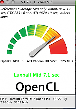

smallLuxGPU is promising as an OpenCL test. Cinebench OpenGL test in a small window is not stressful enough. OpenGL Extensions Viewer has a test that lets you set high resolution full screen, multisampling, anisotropy, etc.
