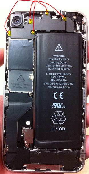

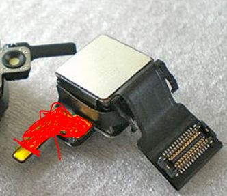

HI, i figure out how to fix that annoying problem, I know for sure many people has been bothering by this trouble.it's easy remove the black shield on the right side of the camera remove five screws, each one has a different size, after that unplug the camera ribbon form the main board and remove the camera from the iPhone after that just put a tape or any kind of adhesive in the golden part leaving only a little part on the edge without adhesive, then place the camera and all the parts in the right place, you are done!!!!!
I've done it in over 5 iPhones and all had worked, I hope that's resolve and help everybody. :)

I did the repair recommended and it worked great. Don't forget to pull the camera ribbon connector out gently before trying to pull out the camera. I used standard black electrical tape cut to the right shape. All in 15 minutes and problem solved. THANK YOU BINJUNIOR

I have the same problem and would love to try this fix......but how do you take off the back of your iPhone 4s?

The fix works BTW, thanks heaps binjunior.apple.
I fixed mine by removing the camera as you have stated. After inspecting the camera, I noticed that there are two pins or tiny resistors on the back side of the goldish tab in your photo. One had a tiny bit of corrosion that was only visible with a magnifying glass. I cleaned it by gently rubbing it with a toothpick and vwala..Fixed.
NOTE: You can see the two pins right next to the camera after removing the back glass. You don't have to remove anything else. Hope this helps someone.
