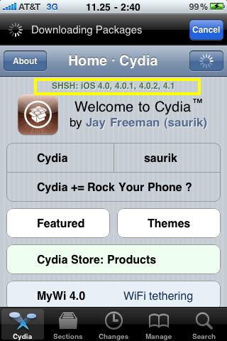

If you've jail-broken, check Cydia - it will be located on the main screen (where I've highlighted it in yellow) if any are saved.

So if the main screen of Cydia has those bit highlighted in yellow, your shsh is saved?

Once you click it for the first time, it doesn't come back up again. Cydia will recognize your iPhone after you restore/update.
The SHSH are saved only when Apple is still signing the iOS. So for example 3.1.3 is still being signed on Apple's servers Cydia can grab the SHSH. When 4.0 came out Apple stopped signing 3.1.3, so Cydia couldn't grab the 3.1.3 shsh, instead Cydia grab 4.0 and on.
Yeah. Sounds like my own situation - by the time I jailbroke my phone, 4.0 was already out, and 3.1.3 discontinued on signing by Apple. Therefore, despite me being on a j/b'd 3.1.3 iOS, I've only the 4.0+ shsh blobs.
