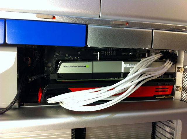

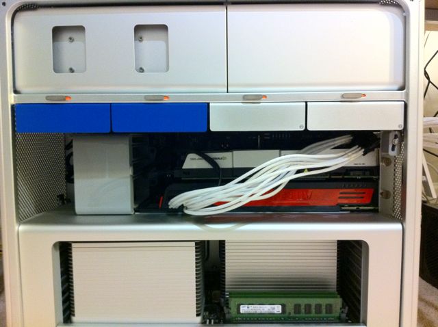

i have a 2010 Mac Pro with an ATI 5870 that i mainly use with Windows 7 Boot Camp. i needed to install a second graphics card, but could not find a way to power it since the 5870 was using the two existing 6-pin PCIe power cables. at first, i purchased a Quadro 4000 for Mac and powered it by splitting one of the two PCIe cables with a PCIe Y-Splitter. everything worked great, although it made me nervous to split the power from one 6-pin PCIe cable.

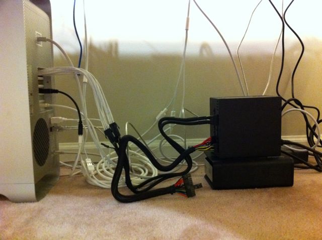

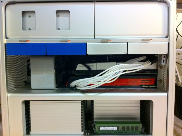

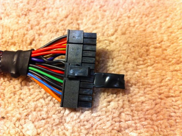

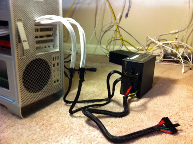

than i returned the Quadro 4000 for Mac for the more powerful Quadro 5000 which also requires one extra 6-pin PCIe cable that the Mac Pro does not have. to remedy the situation, i purchased an external Seasonic X-Series 660W modular power supply. i ran two PCIe cables from the external power supply in through the top-most PCI slot (an empty slot) into the 5870, and used one of the two existing internal PCIe cables to power the Quadro 5000. after jumping the external power supply's motherboard connector with a paperclip and electrical tape, everything seems to be working great in Windows 7 Boot Camp. i just have to remember to turn the external power supply on and off. here are some pics :)

You can probably create a simple circuit to detect power on at the Mac, and make the jumper connection to the external PSU. This way you don't have to manually turn it on and off.
Here's a thread about using a second internal power supply to accomplish the same thing. It is purposely shaped to fit a 5.25" drive bay and senses power on/off by connecting to an existing molex connector:
https://forums.macrumors.com/threads/1049668/
Why are two of your drive sleds blue?
the two blue drive sleds are "OWC Mount Pros" (http://eshop.macsales.com/item/Other World Computing/MMP35T25/). they allow me to mount 2.5" drives into those four sata bays . each of those OWC sleds has a 115GB OWC SSD mounted to it, one for OSX and one for Windows 7 Boot Camp...its worked out great. they are a little bit on the expensive side, but worth the cost for their function and build/design quality.

That's a nice setup; curious though, how does the Q5000 performace compare with the Q4000? Also, do the heat & noise compare?
Isn't that annoying? Why didn't you go the 5.25" PSU route? Personally, I think it's the more convenient solution.
hello...yeah, very annoying :)
i did not go with a 5.25" PSU for two reasons. the first is because i have a hard drive in the second optical bay that i wanted to keep there. and second, i couldn't verify the quality of the 5.25" PSUs that i found searching the web. i knew that i wanted to buy a high quality PSU if i was going to try and power a graphics card externally.
you know, so far the Q5000 and Q4000 seem similar in noise and heat. once i've had a chance to work with the Q5000 a little more, though, i think i'll be able to say more about its heat/noise and performance attributes.
the Q4000 was louder than the ATI 5870. the Q4000 fan kicked on intermittently throughout the day as i worked. if i was working on something that taxed the GPU, then the fan would stay on for a while, and then the Mac Pro fans kick up a bit. i kind of like it when i hear the fans working....it lets me know that i'm really using my Mac Pro. and the Q4000 gets hot, and i mean really hot. so hot, that i couldn't touch it after about 1-2 hours of prolonged use. its not something that concerns me, cause i'm sure the Q4000 was built to handle the heat...and it is very well constructed by the way...but yeah, it gets hot.

after a couple of days using the Quadro 5000 with Maya 2011 and Octane Render, i can say that the 5000 is louder than the 4000. it seems to be almost 50 percent louder. at times it will get quite, but i can usually hear the 5000. i'm not annoyed by it, though, cause the power of the card is awesome. the usefulness of it outweighs the noise for sure.
and yes, it gets hot, really hot...but i think that the Quadro 4000, 5000, and 6000 are known to get really hot. they are really well constructed though, and i've got a 5 year warranty on it, so i'm not worried.
all in all i'm happy with the Quadro 5000. the only problem in my entire setup is my Mac Pro. i think next time around i'm going to build an expandable PC and save myself a few thousand dollars :)
Old thread, but why was the paper clip used to jump the motherboard on the PSU?
EDIT:
Okay, how do I know which holes to put the paper clip for this?
EDIT:
The paper clip is used to turn on the PSU. You just jump the green wire and any black wire. There's one green wire so it's easy to find and any of the multiple black wires.
