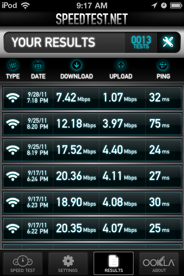

on a 100Mbit connection through wifi N I could only ever get 13.5Mbit, you can force a server on the speedtest in the settings, do that and post a picture of the speedtest here (you take a picture by pressing the home and sleep button together) I want proof that it can achieve over what I got - pics or it didn't happen as the internet says.
no it doesn't the ipad and ipod touch are totally different, they use completely different wifi chips, so that article can only be applied to the iPad not the ipod touch
Yes they use different chips, but both only support 5/6 ODFM coding so this article still applies.
Also here are several results over 13.5mbps for you.....
