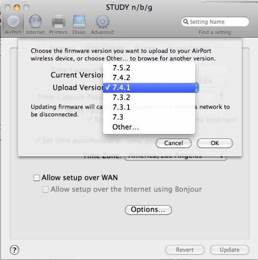

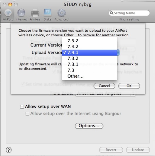

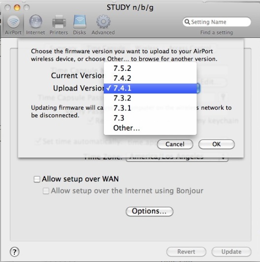

If you select in the Airport Utility top toolbar - "Upload Firmware" from the AEBS drop-down menu, you will be given a selection of which firmware you need:

This is because you guys actually have that firmware saved on your computer in the ~/Library/Application Support/Apple/AirPort/Firmware folder. I don't have this and I cannot revert back to an earlier version because of it, as I've said a couple of times above.
Could one of you guys post a link to or somehow zip and send me your ~/Library/Application Support/Apple/AirPort/Firmware folder? It would be much appreciated.
