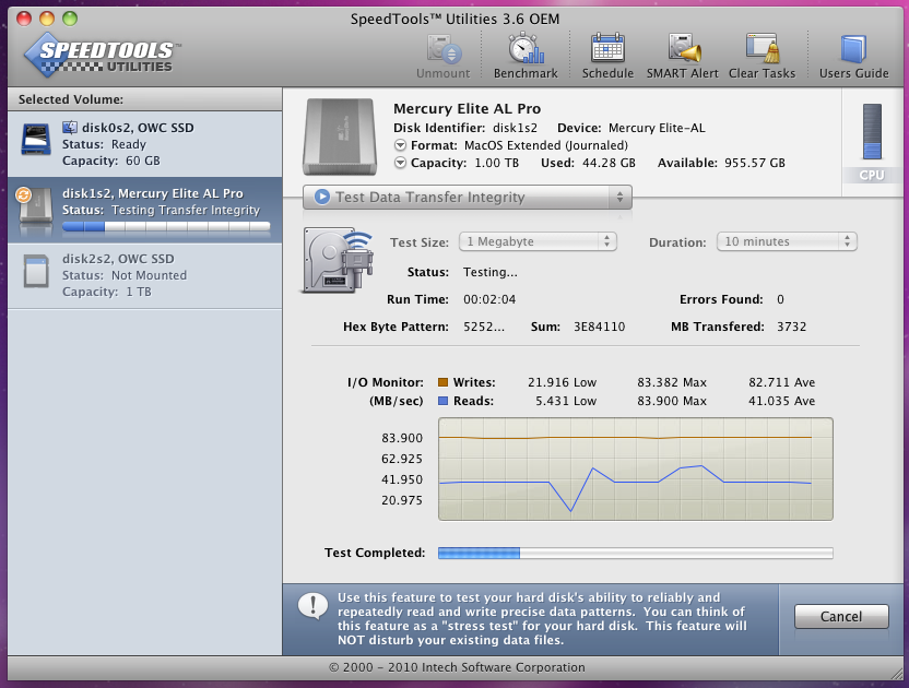

I've had this drive maybe a week and I'm already seeing weird read/write spikes when performing tests. As you'll see in the picture below, there is a sudden drop in read speed. At that very moment, there is a 'clicking' sound coming out of the drive enclosure. I can validate this occurring many times during a 10 minute (1MB) test. Clicking sound, and then a drop.
What the hell is going on?! 😕
Thanks for any help...
-Alex :apple:

As far as I know, SMART isn't supported on it.
The day I got the drive I checked the SMART status, and got a message something to the extent of, 'SMART not supported on this device'.
After unmounting the drive, turning off the power supply, then turning on the drive and re-mounting, I didn't hear the 'clicking' anymore. I'll have to do more read/write tests this afternoon, going to sleep now. It's 6:40AM here 🙂

EDIT: They said that my situations like mine aren't uncommon. The Technical Service guy said that the drive was 'pulling' (Hitachi Dekstar drive apparently inside it) when it made the clicking sound. When it pulls (I assume to read the data it has written) all other activity on the drive quits until it catches up with itself. He told me copy all the media currently on the drive elsewhere, and then reformat the drive to Mac OS (non-journaled), and see if that helps.
So, I'm currently moving my files onto my internal hard drive, and about to format the external enclosure as he recommended. If I continue to have issues, I'll demand a replacement or a refund.
