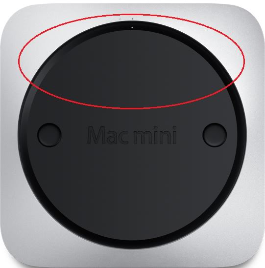

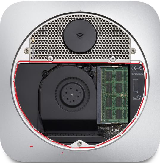

Yes, when the cover is on, the red part will be sealed as shown below. Air travel through as MJL said.
And the air should be sucked in from the front as circled below. Not the back as mentioned in ifixit.

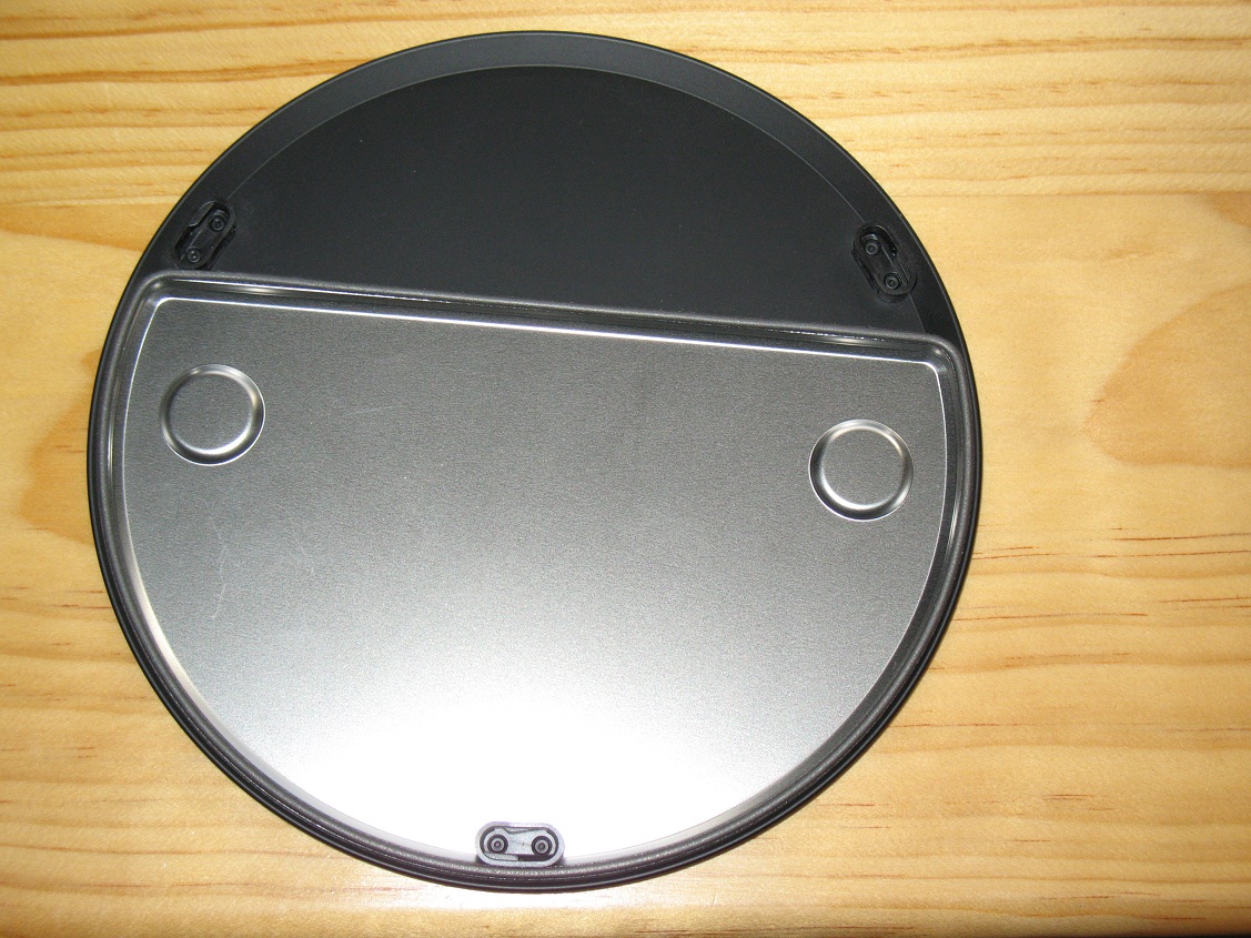

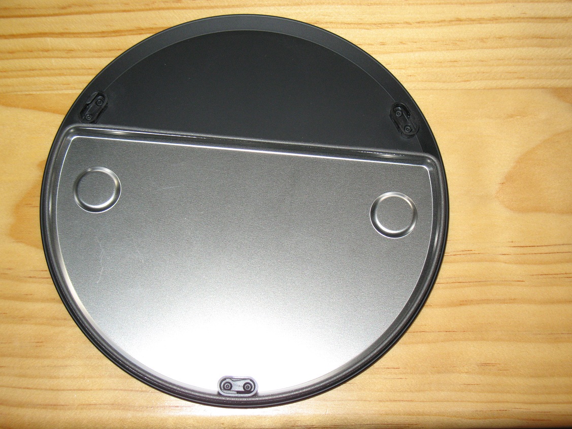

The "inside" of the plastic base, you can clearly see the rubber seal that stops the air getting directly into the area outlined by the red line in the previous post.
philipma1957: Many thanks for the link to those excellent feet, these arrived today.

I have 5 pairs of black ones on order. I have a few clear ones on hand. They truly kill two birds with one stone. No slippage and they raise the mini for better air flow.

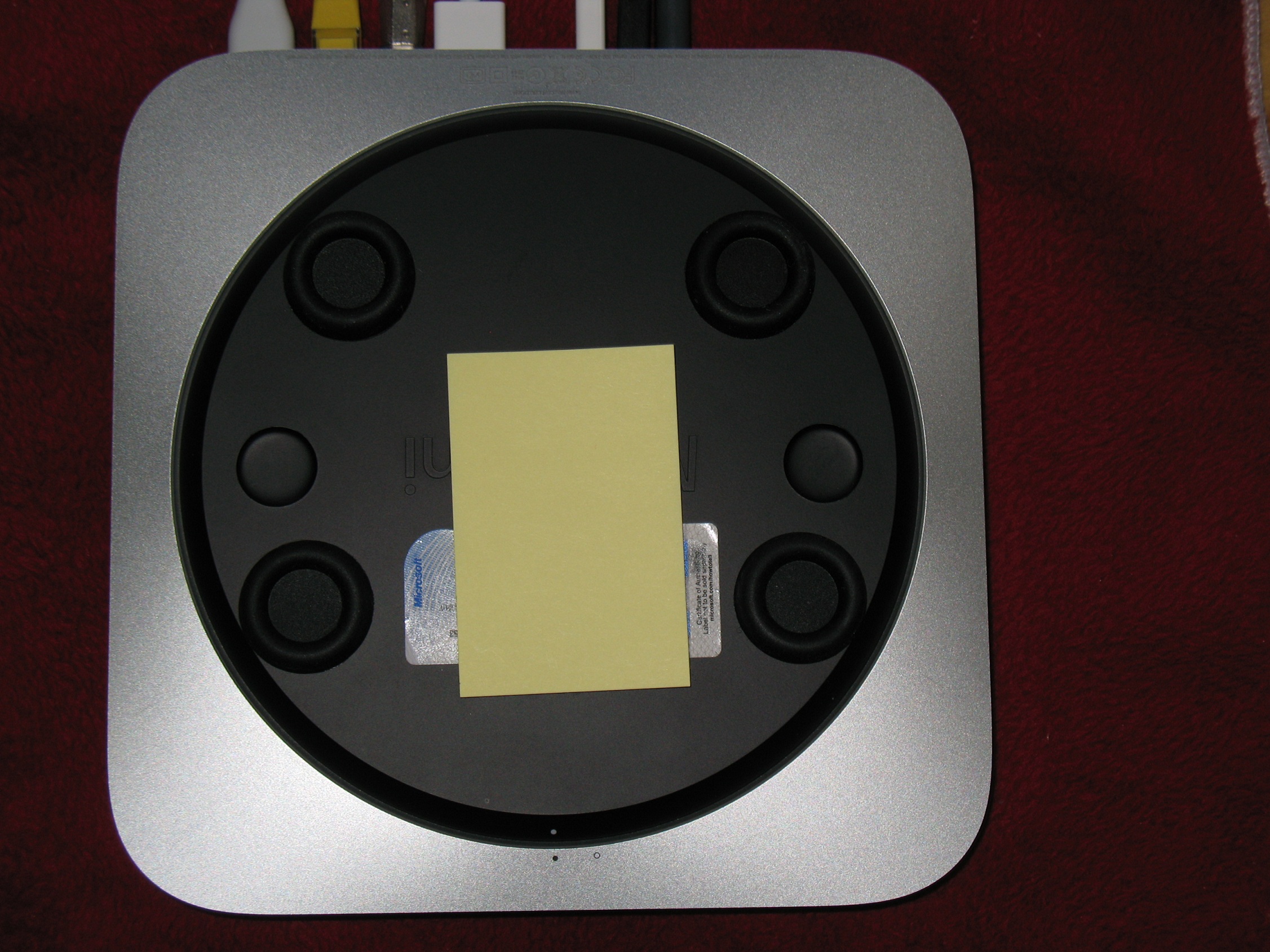

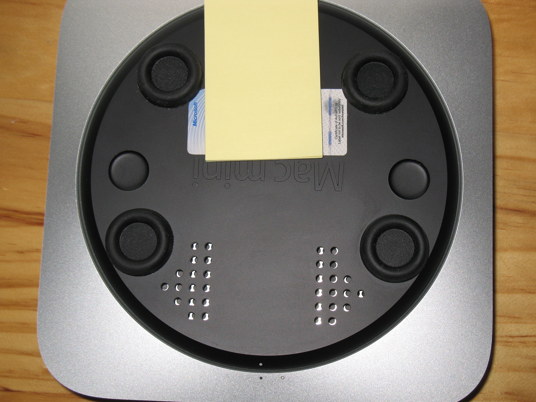

Added benefit of having those feet: I've now got a place to affix the Windows 7 license sticker.... IF (big IF ) you are adventurous then you can drill a series of small holes in the black area and then use a vacuum cleaner's exhaust airfilter cut to size between the black part of the base base and the grille around the antenna. No more inside dust and no need to clean the inside of the computer ever, just replace the filter once a year.
I've build tube amplifiers in the past and if you've got a drill template then you can space the holes nicely and have a professional looking job.

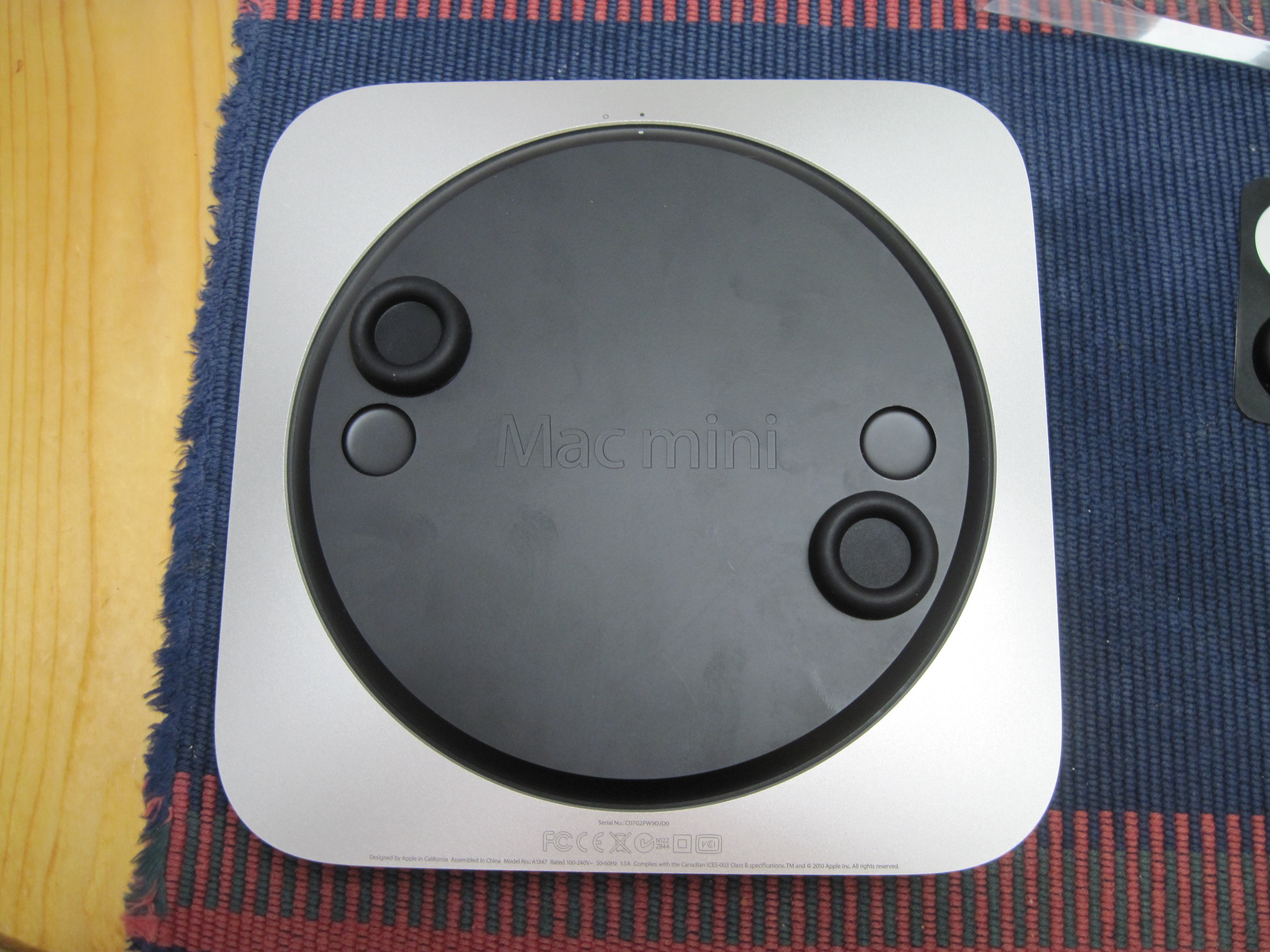

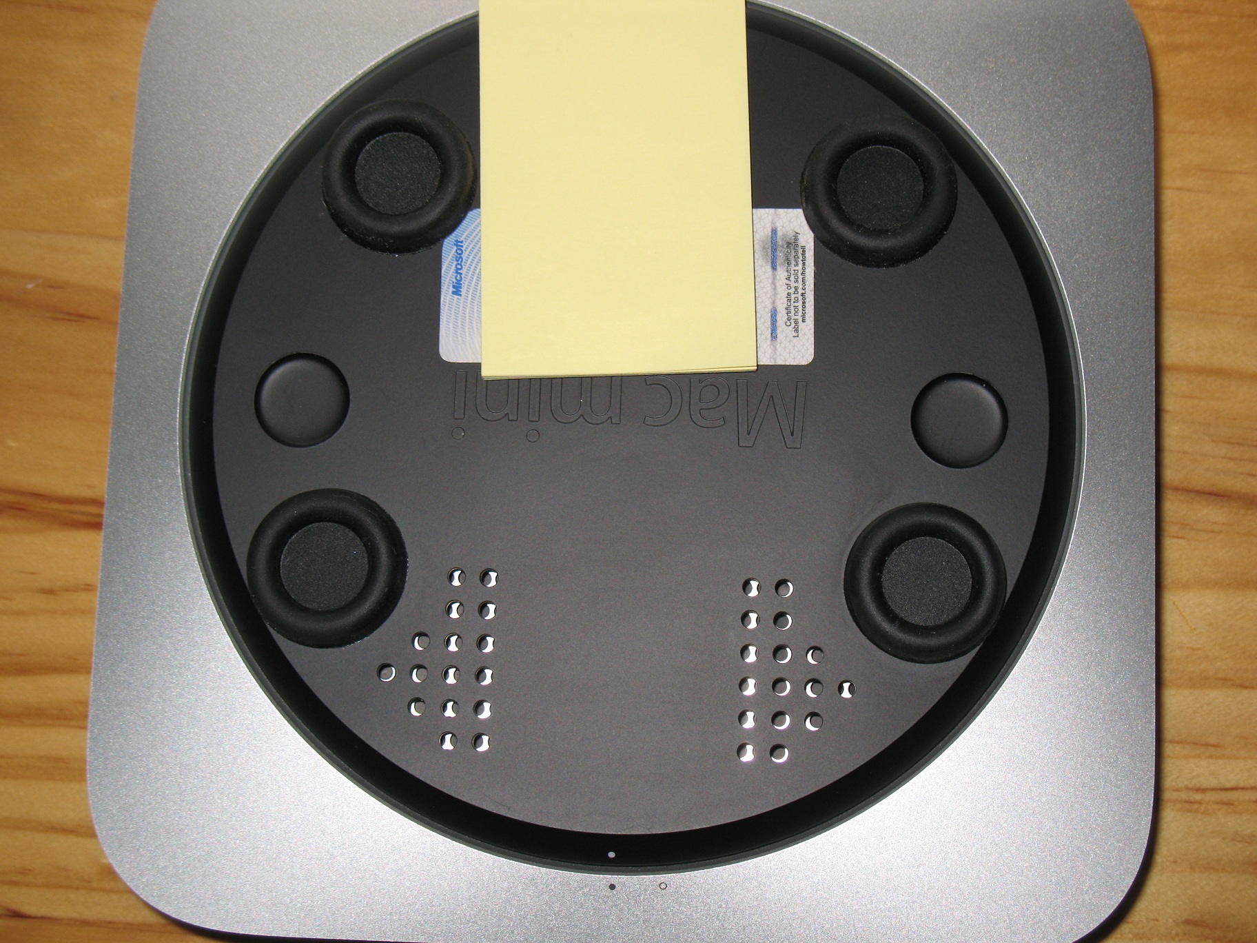

Here you are. Initially I placed three feet exactly under the three standoffs however this created some easy tipping when leaning the hand on top to switch the computer on. Also the cables hanging over the edge of the desk were creating some instability. I left the two feet that are in the front exactly over the two standoffs (after all the bottom is only plastic in those locations) and put two feet closest to the corners of the back (has metal backing so less deformity of the bottom cover). (drew with soft pencil a few lines on the aluminium body to locte the studs and the diagonals from the corners). As mentioned before I finally managed to find a spot to affix the MS license label .

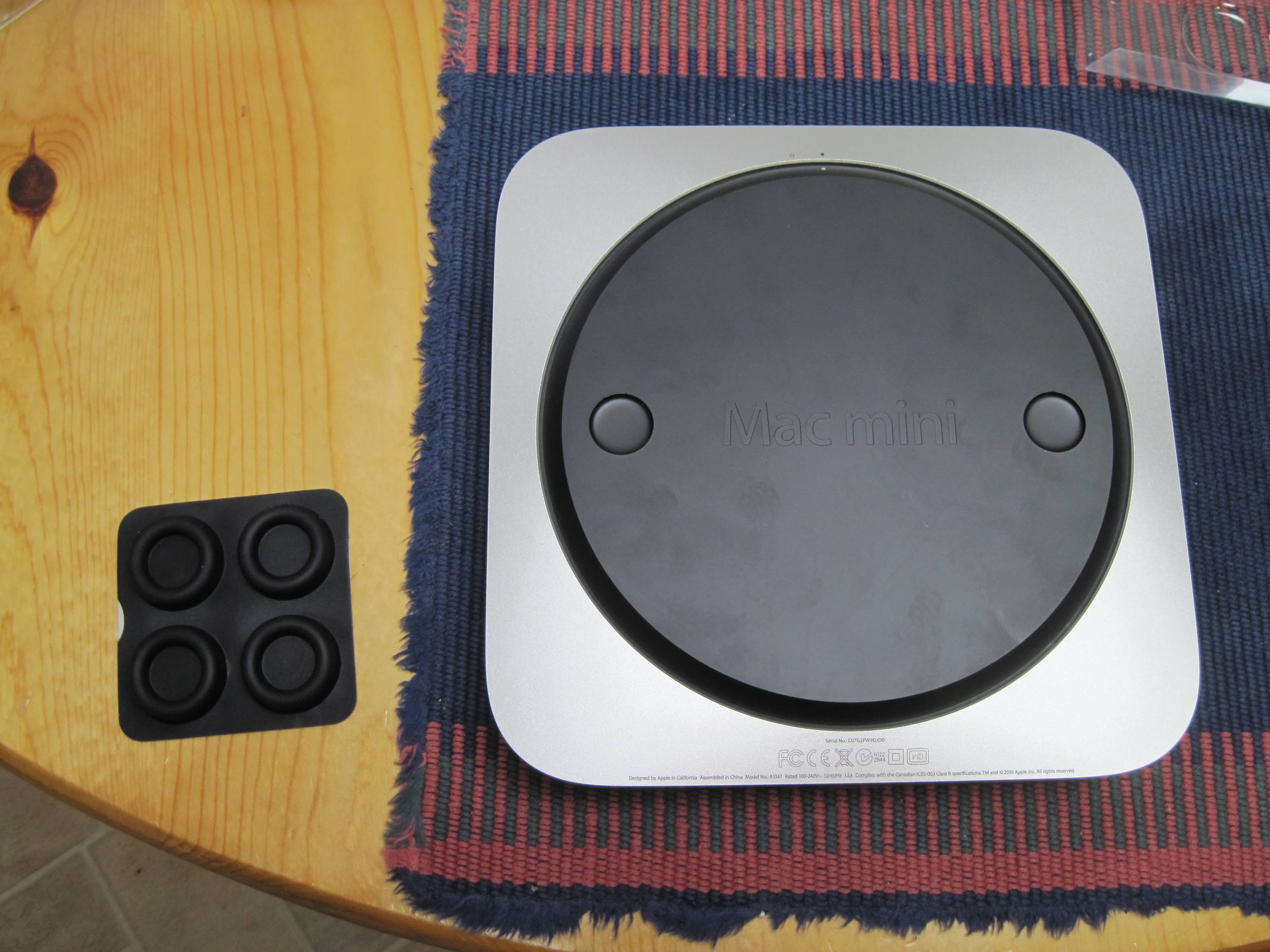

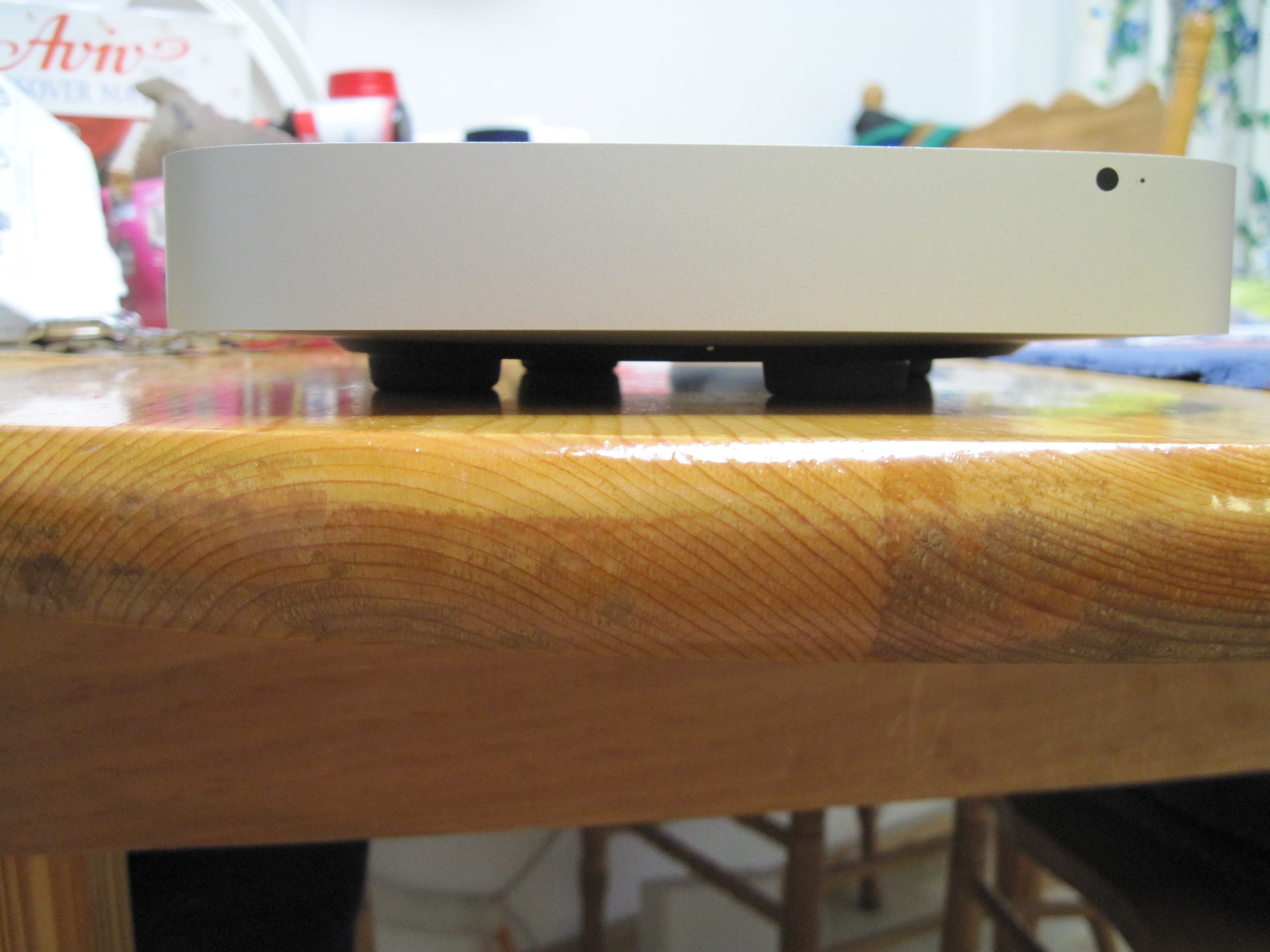

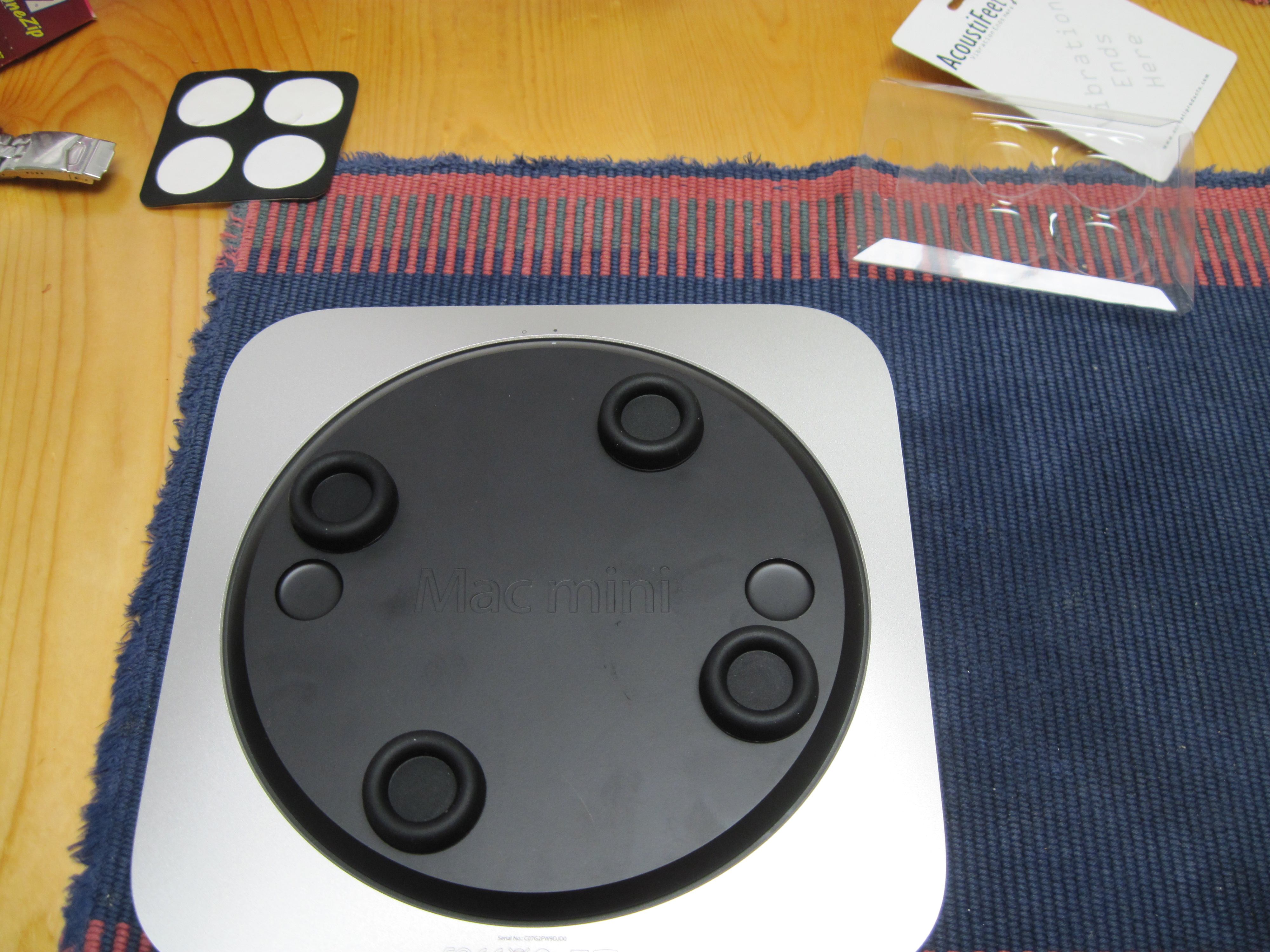

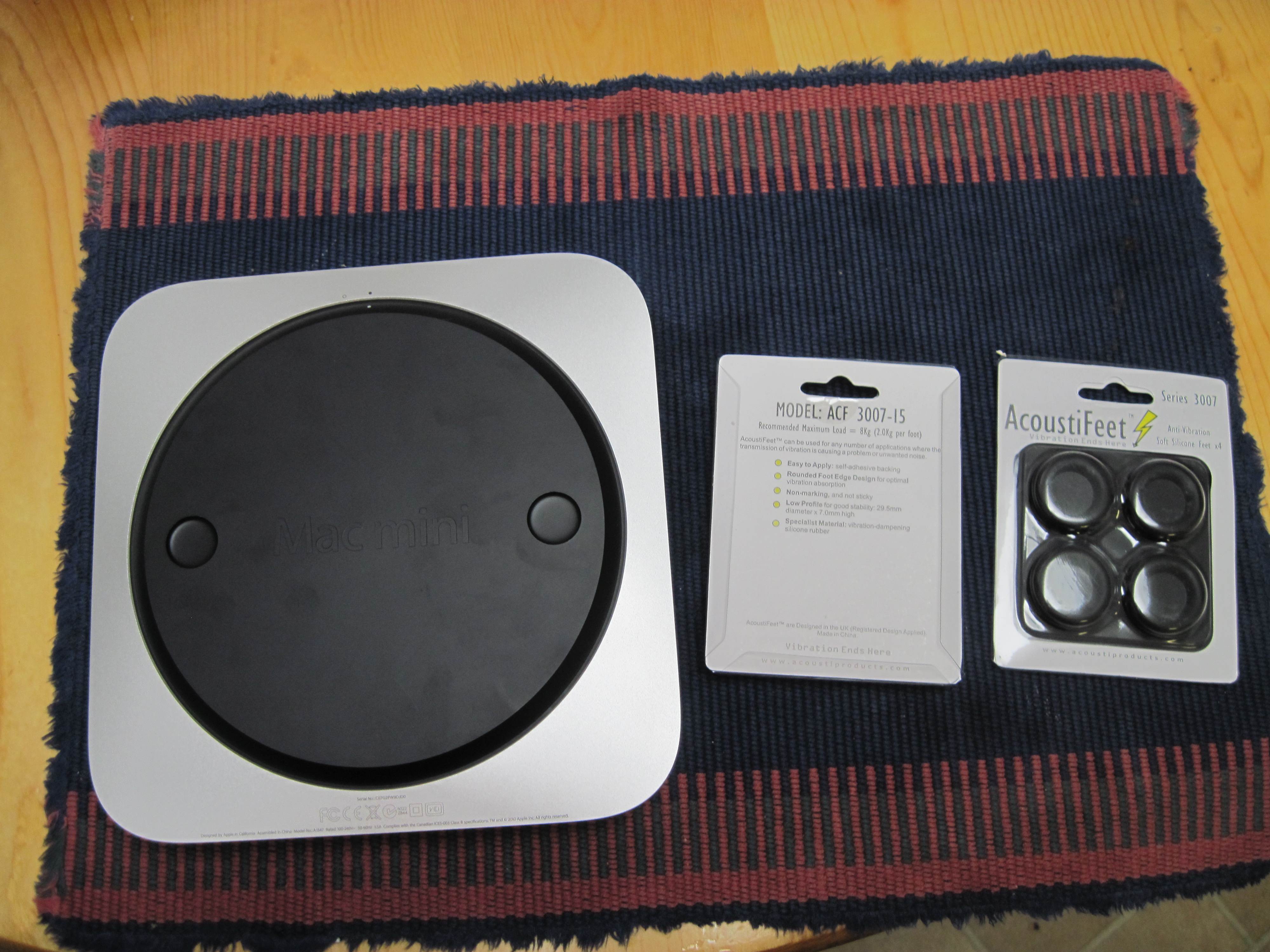

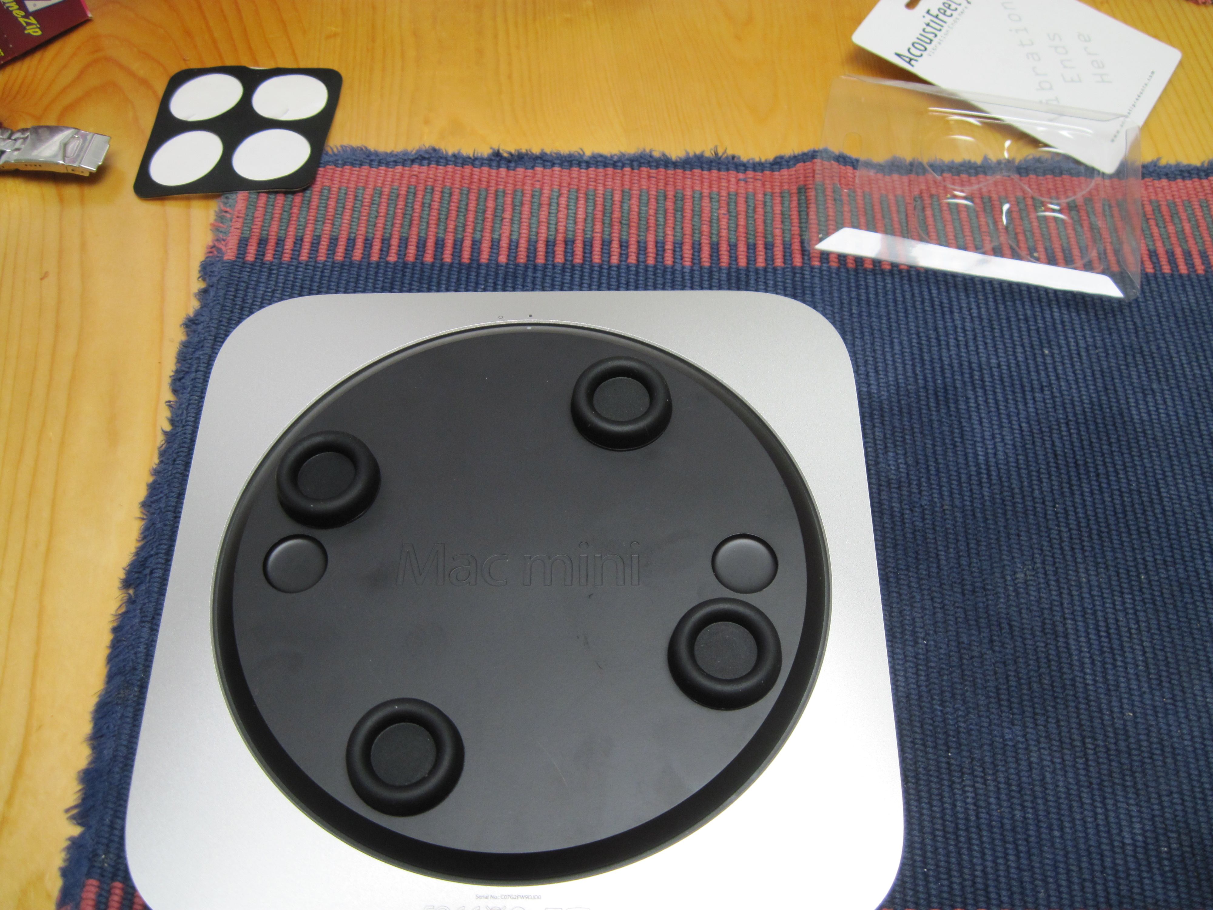

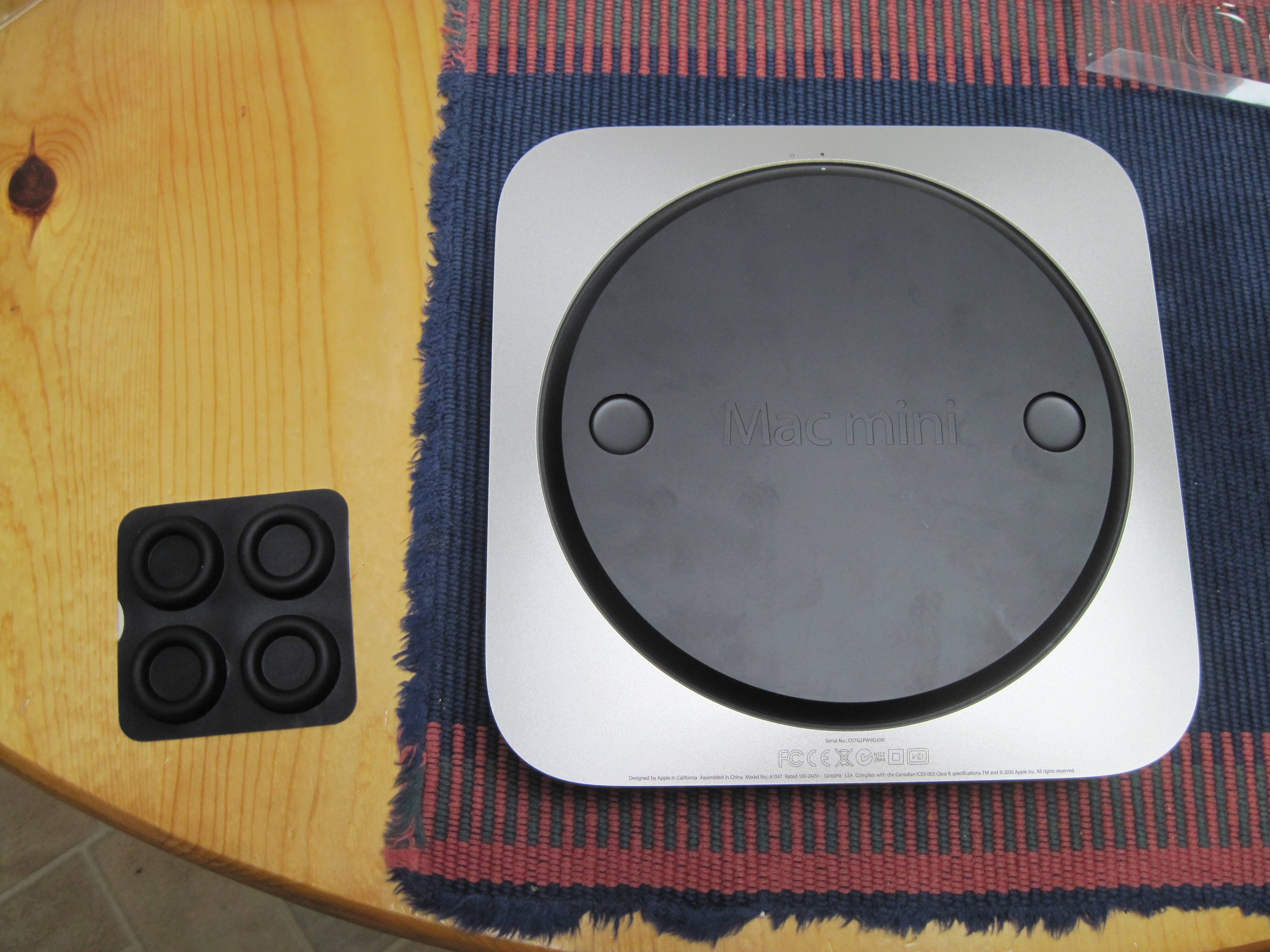

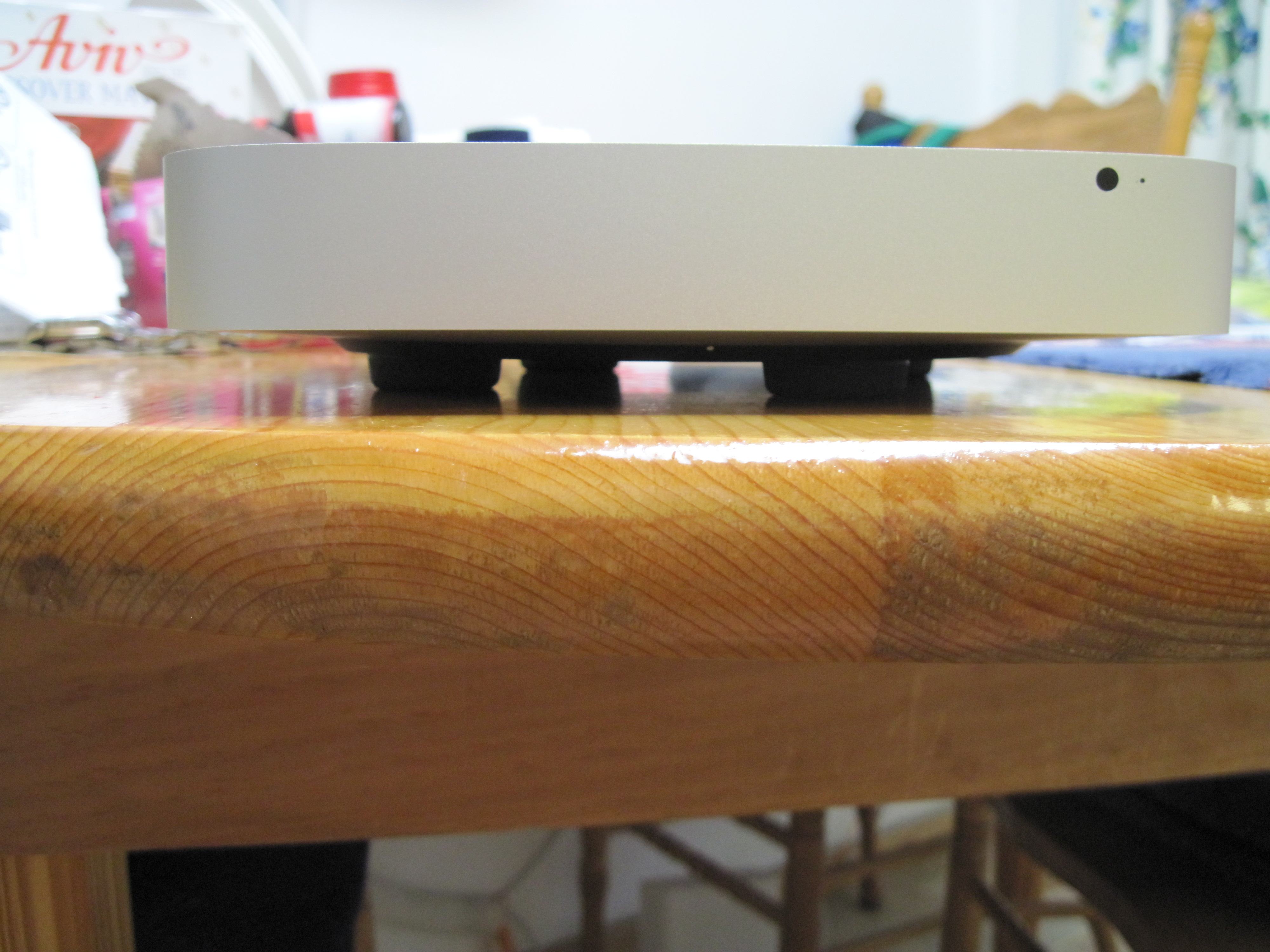

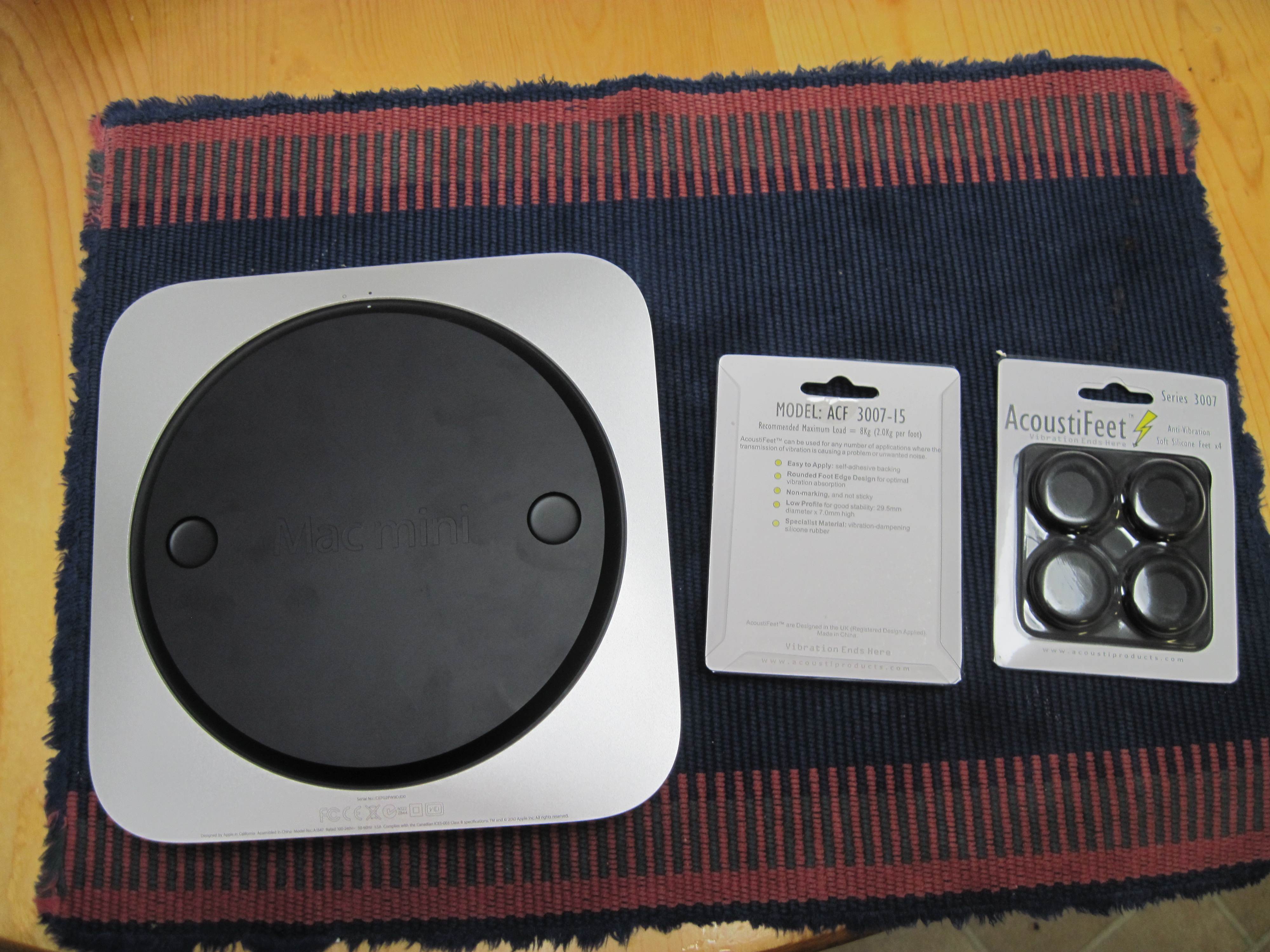

here are my photos. notice the size number these are the lite duty ones best for under 20 pounds.

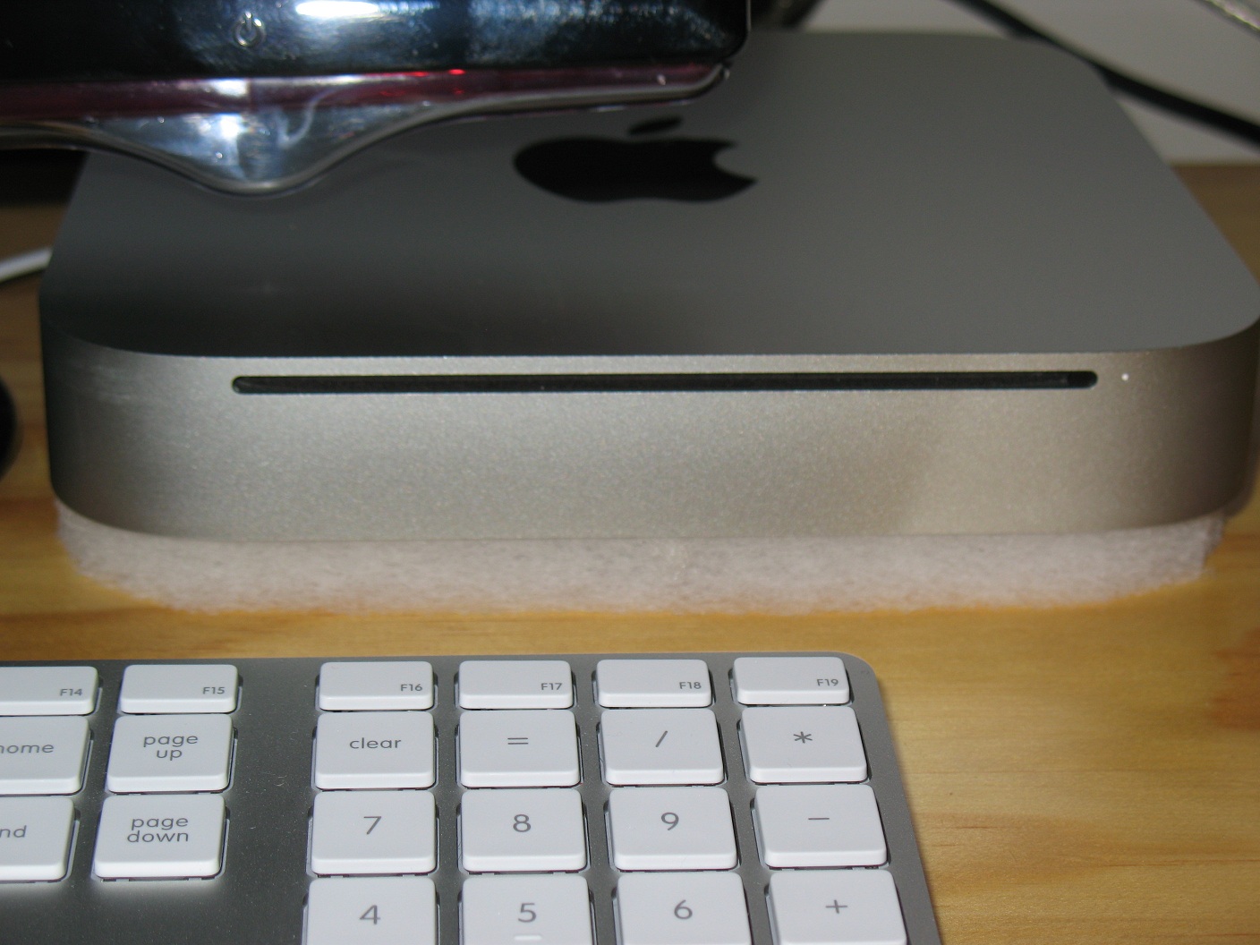

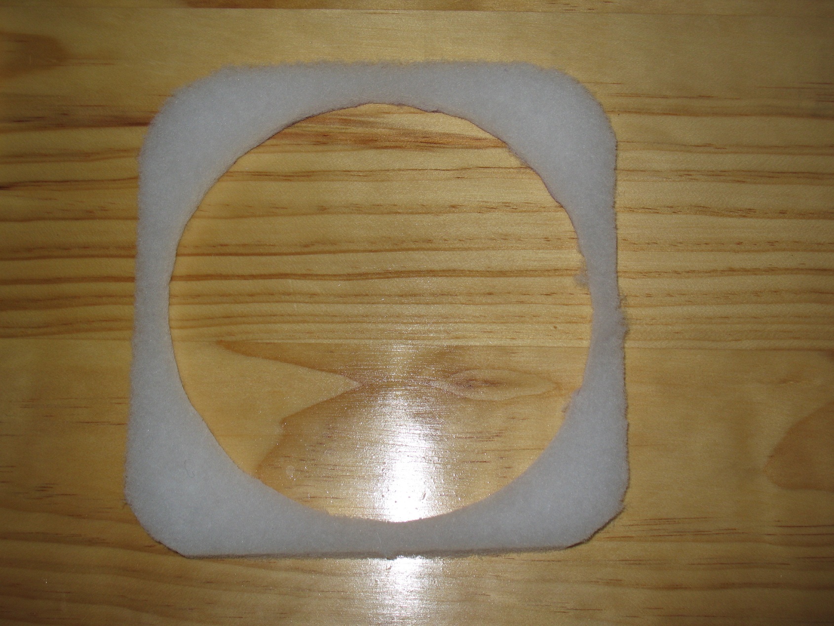

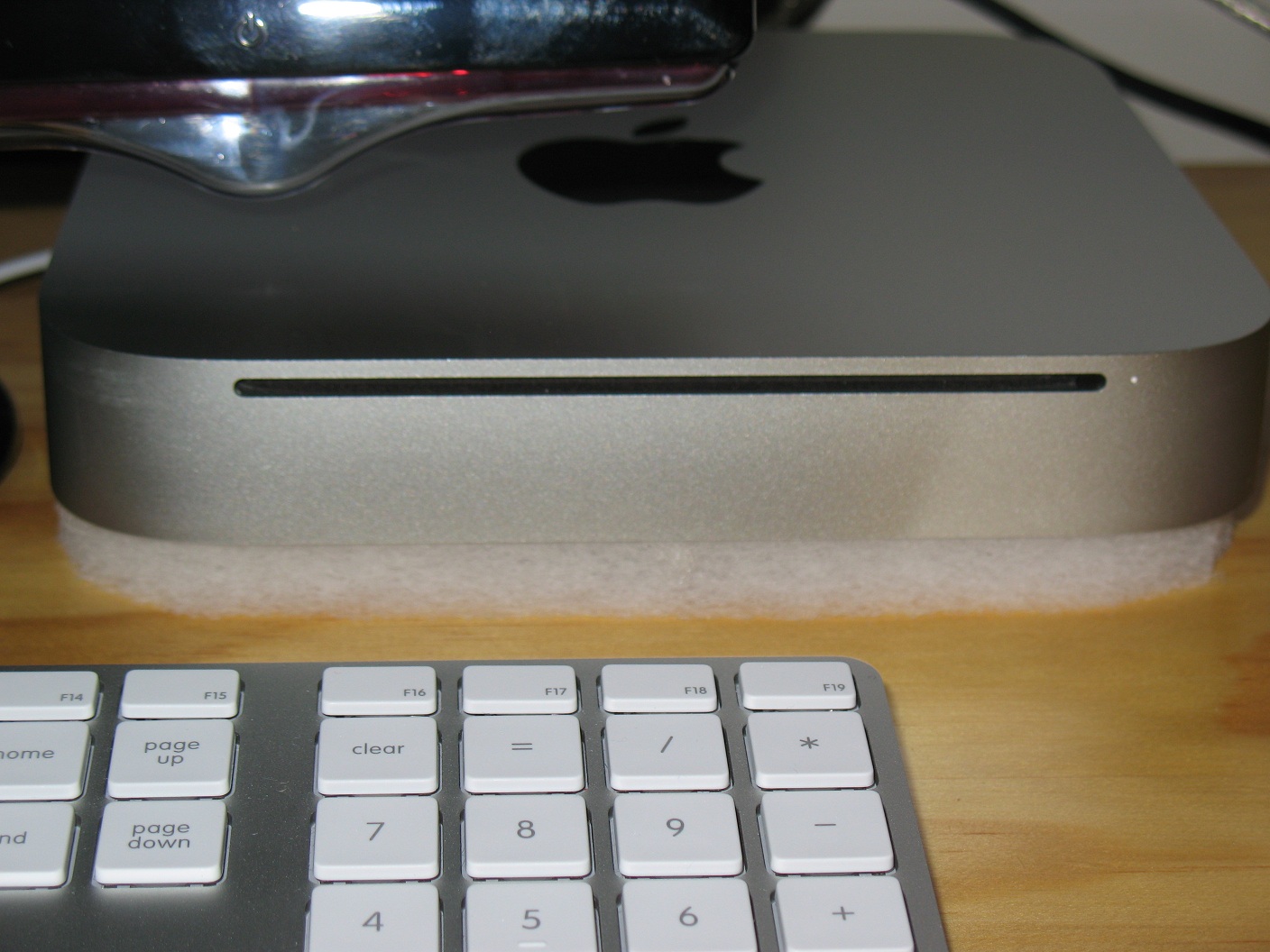

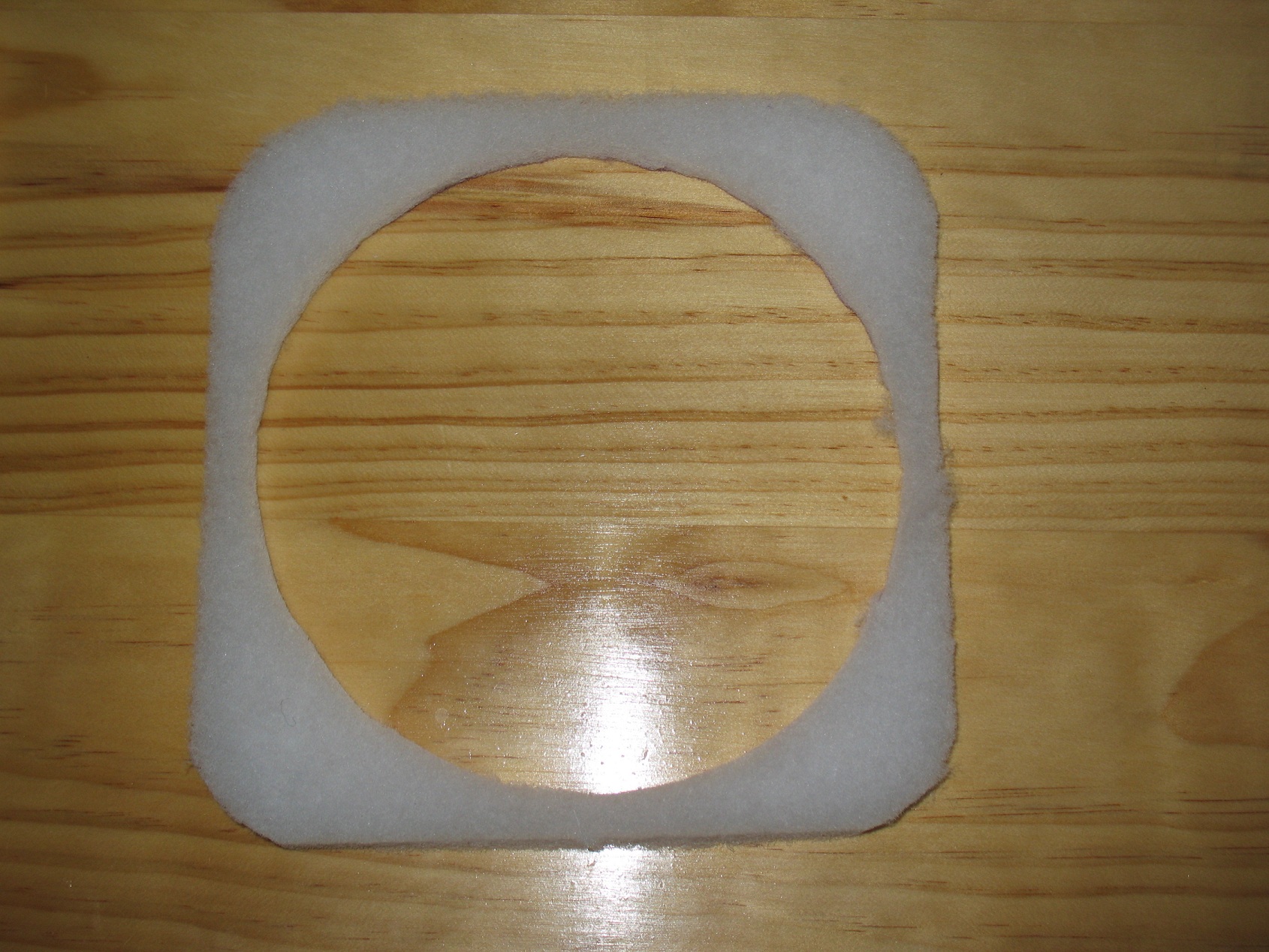

Non destructive air intake filter
Had some 16 mm thick polyester fibre filter from an air filtration system and cut it to fit underneath the Mac Mini. No more inside cleaning, yeah!

I would do it differently. I'm afraid for your Mac mini. There's not enough air going through the bottom of your Mac mini. It looks like it suffocating. (And vacuuming it once and a while isn't that bad.)

I suspect you are thinking about "normal" foam however you need specialised air filter foam / polyester and the restriction all depends on the PPI (Pores Per Inch) http://www.newenglandfoam.com/filter.html Let me assure you that this is not creating any more drag on the fan, most of the drag is caused by the narrow gap between bottom cover and the aluminium housing.
Proper vacuuming needs almost complete dismanteling to get at all parts and with rapidly worsening arthritis it is something I have to avoid. This air filter only needs the occasional dunking in the kitchen sink.
Besides dismantling voids the warranty.

Have added some extra ventilation holes in the bottom. Also (as mentioned elsewhere on the forum) it is possible for the i5 and i7 CPU's to turn off the Turbo Boost in Windows 7 by setting in "control panel" - "power options" the "maximum processor state" under Processor power management" to 99%.
( http://tautvidas.com/blog/2011/04/di...l-turbo-boost/ )
No sense in drilling holes in the middle since there the WiFi antenna will be blocking the holes.
I'm doing this in anticipation of buying i7 server and to investigate how much the temperature drop will be.

Good to hear your feedback.
I've bought in the intervening period the 2011 Mac mini with discrete GPU and am running only Windows 7 (OS X removed from HDD). The ventilation holes shown in pic above were 1/8" and they have been enlarged to 11/64". This made no difference in air movement at higher rpm versus the 1/8" holes and did weaken the bottom so placement of rubber feet becomes critical. (far more flex in the bottom in the area above (or below; depending if the machine is upside down or not) the antenna. I even went sofar as using some amplifier heatsinks on the sides (attached with thermal tape) which did keep the enclosure a lot cooler but the internal temperatures were barely affected (2 - 5 degrees C depending on sensor). In the end I took those off again (did not like the look).
I've come to the conclusion that the internal airflow is properly designed and that the enclosure after a long enough time takes on almost the internal temperature.
I am of the opinion that the airgap around the bottom is on the (marginal) small side (OK for the 2010 Mac mini). If this is combined with the computer sitting flat on a desk then one can see that the air gets "pre heated" by the hot enclosure. This has as result that the fan is working harder.
I am using Mac_Fan0_65 to manually set a minimum rpm under windows and when browsing etc have it at 2100. When running unattended with some 10%-15% load I have it set at 2300 rpm (same as the minimum server speed) and it stays pretty comfortable at that level.
