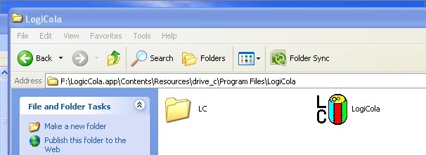

Copied it to USB and it ran fine on my Mac from there. Connected to Windows and accessed it in
USBDRIVE:/LogicCola.app/Contents/Resources/drive_c/Program Files/LogiCola/LogiCola.exe

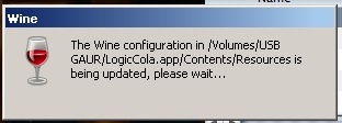

There is no need to install on each machine but you need to wait a bit for Wine to reconfigure:
