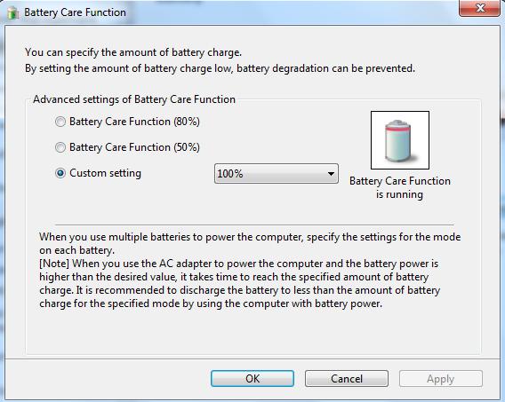

All I want is the same level of charge control that Sony offers:
