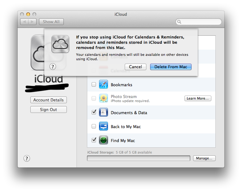

Here is what it says when I uncheck "Calendars" in iCloud:
Why can't I just STOP using iCloud but keep my iCal? That's the way it was before I had iCloud...

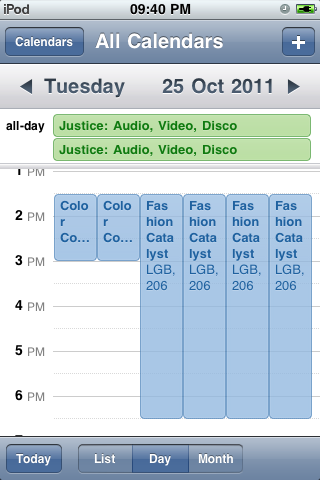

However, now, when I sync it to my iPod Touch (2nd Gen), every single entry appears THREE times! What the hell is going on?
I now restored my iPod, I unchecked "Sync Calendars" and I even checked "Replace information on this iPod: Calendars", and none of this helped. I even restored an old iPod backup from Time Machine (User Library > Application Support > MobileSync > Backups), and then restored my iPod again to that old backup, and while it was fine after the backup was complete, upon the next sync I again had 3 copies of each event.
To make matters worse, the copies synced back to my Mac and now I also have 3 copies of everything on my Mac.
This whole thing is going to hell, could someone help? I can get my Mac's iCal back to normal from the exported backup, but my iPod always syncs in a way that I have 3 (or 2, or 4, it depends) copies of events on my iPod.
