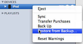

When you connect the phone to your computer - and it's icon shows up on the iTunes sidebar - control / click on the icon and you should see a drop down menu with the option to restore.

Since you said you have Device Backups listed under your Preferences, if you've set up as a new phone, you can simply do this:
1. Connect your iPhone to your iTunes
2. Your iPhone's name pops up on the left column
3. Right-Click on your iPhone's name
4. Select "Restore from Backup
