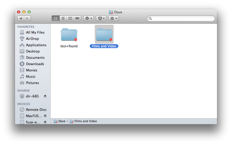

I am having a problem with my DLink DIR-685 router which has an internal hard drive. It works flawlessly with my windows machine, however I am having no such luck with my Macbook Air running Lion.
So this hard drive inside the router is in EXT3 format which is probably causing the problem. However I can access it through a little app called muCommander, which is like an alternative to finder. But since I want to access the hard drive through finder so I can refer to the folders on the hard drive through applications, it has to be done through finder.
I have tried two apparent work arounds which have both failed. These are MacFUSE and Paragon ExFS.
So to help explain what I am doing I have attached some images:
Firstly I click on the hard drive in finder, under shared:
Then I proceed to the first folder:
The 'no entry' icons in the corner of the folders signify that I cannot access them and the following message pops up if I try to do so:
Is it even possible to access these files on my Mac. There are no permission restrictions assigned to the folders since I can access them no problem on my windows machine and I have set the storage access setting on the router to open which means anyone can access the files.

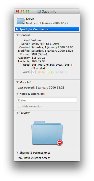

Select the folder you do not have sufficient permissions for and hit command i
after that you will see a window pop up and towards the bottom you will see a sharing and permissions-click on that arrow and make sure your user account is set to read and write privileges. LMK if that doesn't resolve the issue and we can try some other things, best o luck

Didn't work, here is what it says under get info:
