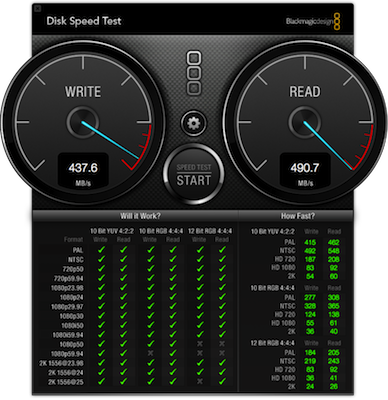

Testing my Vertex 3 with pre 2.1 version

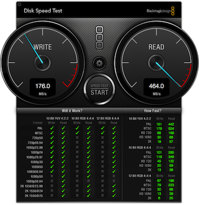

and with 2.1
Same SSD, 2 very different results. There is absolutely no change in the MBP speed.. (still boots up in 20+ seconds)
It is as fast as it is supposed to be. Smaller drives (240GB is almost twice as fast in write speed) are bad in write speeds & Sandforce are worse at incompressible data.
If you check here.
The AS SSD bench is with compressed data.
For normal OS workload and installing apps it makes little difference and the Sandforce is actually better. For copying movies and big rar files around it is bad and the non Sandforce drives have the edge. For a lack of any source/target to copy the big compressed files too the latter is today usually not a limiting factor.
