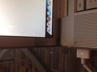

this is what i did to fix - epoxy on both sides (2 small nails to reinforce on the inside, razor blade outside):
fix for cracked bezel
I used rubber cement and a small piece of aluminum (you can buy this in a roll at any home depot like store, typically used for roofing flashing) to reinforce the crack.
The advantage of rubber cement is that it is a little flexible which distributes the strain. Just be sure to read the direction on the rubber cement, it is not applied like glue.
Running on 6 months without issue or worsening.

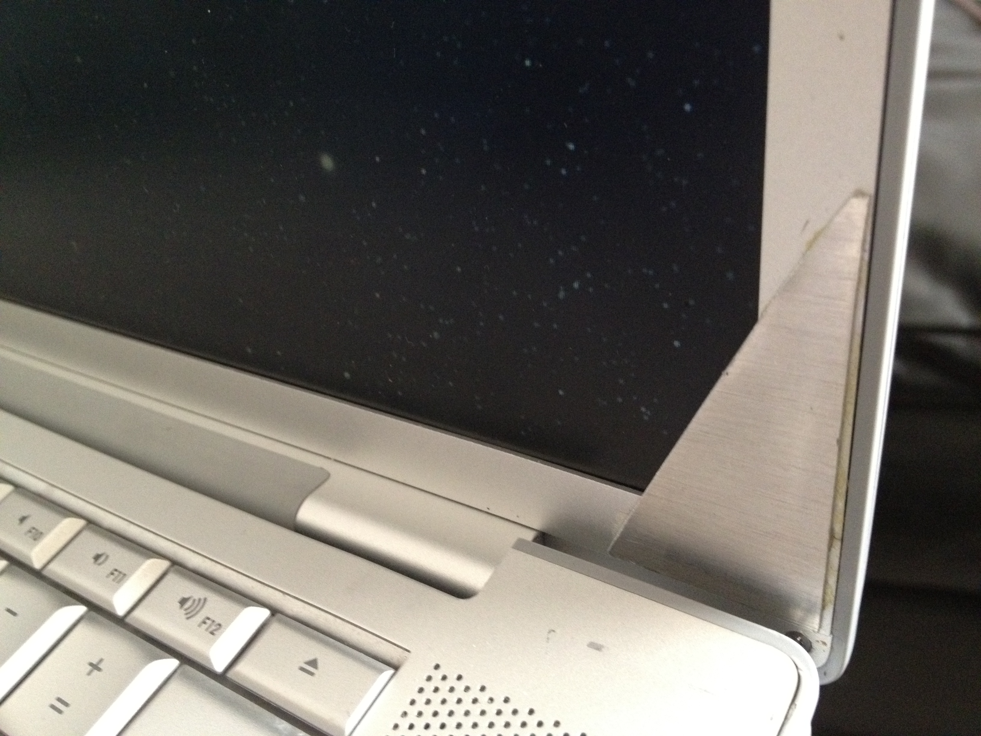

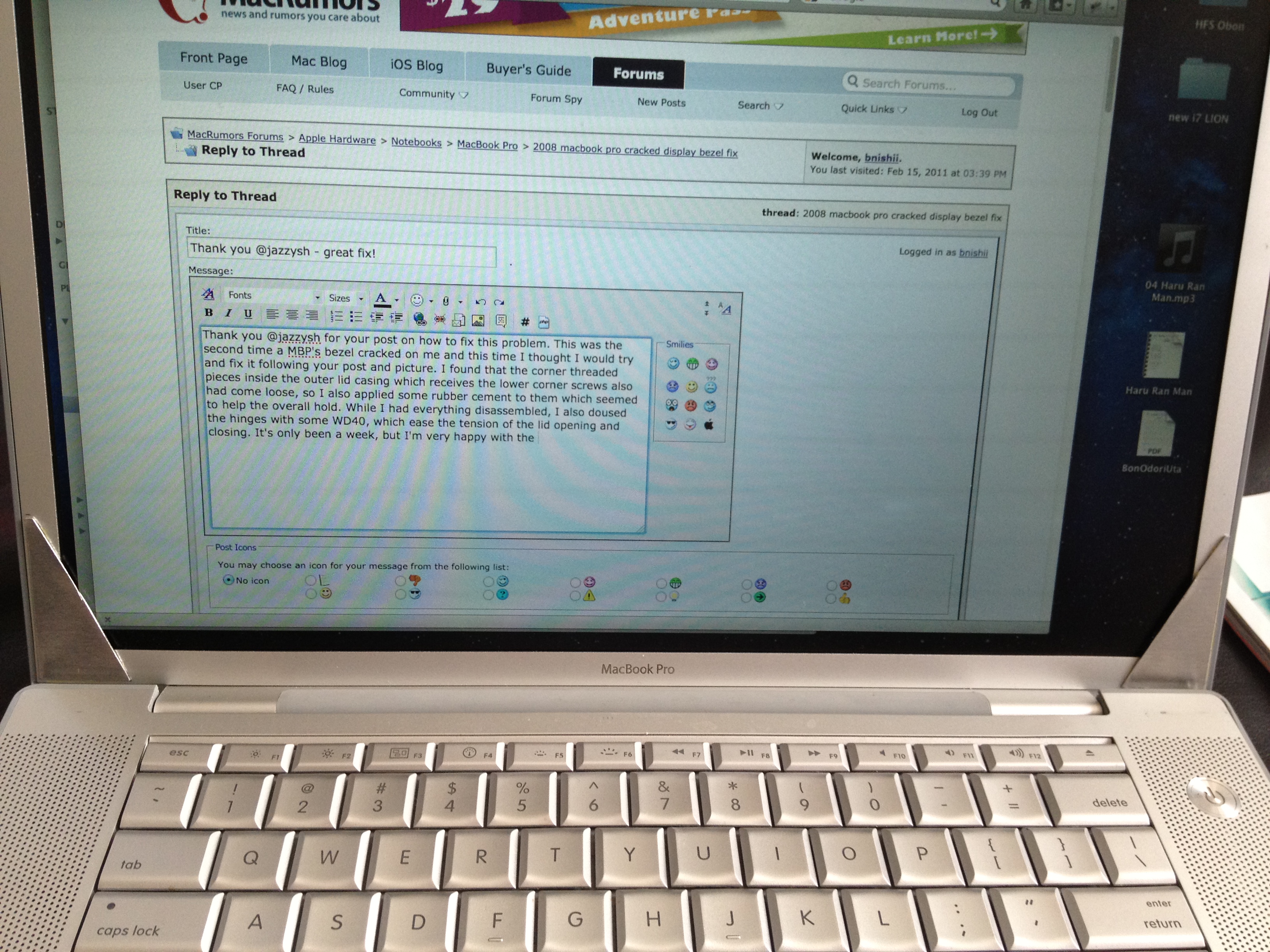

Thank you @jazzysh for your post on how to fix this problem. This was the second time a MBP's bezel cracked on me and this time I thought I would try and fix it following your post and picture. I found that the corner threaded pieces inside the outer lid casing which receives the lower corner screws also had come loose, so I also applied some rubber cement to them which seemed to help the overall hold. While I had everything disassembled, I also doused the hinges with some WD40, which eased the tension of the lid opening and closing. It's only been a week, but I'm very happy with the mend. I pray it holds for a good while longer.

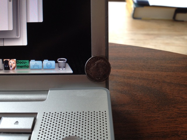

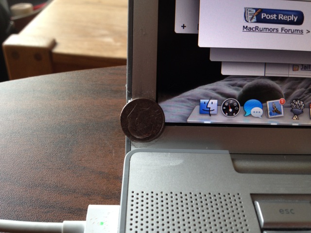

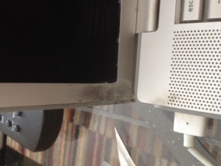

I have a beloved pre-unibody 2008 MacBook Pro and this year those dreaded cracks developed in the bezel - all the way through on the left side and part way on the right.
My wrinkle on your fix was to epoxy dimes over the cracks. That seems to have firmed things up and solved the problem, but of course time will tell. Be very careful if you try this because there is barely enough space to accommodate the dimes when you close the lid.
My first thought was to use single edge razor blades but I wondered what airport security would make of that.
Anyway, thanks for the good ideas. I'm attaching two photos of my repair.

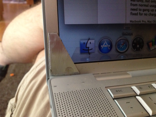

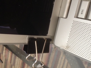

I have a MBP 15'' and the left and right corners of the screen have been cracked for at least a year or 2. The bottom part of the screen was coming detached even further so I finally decided to fix it.
Step 1: First, I used super glue to carefully glue all the parts of the screen that were coming unglued. This helped align the cracked corners and held them in place.
Step 2: I then cut two thin strips of metal, hammered and rolled them flat.
Sept 3: Scour the corners of the screen with a file/sandpaper and the two strips of metal you cut to size.
Step 4: Next, I used Guerrilla Epoxy and clamped the strips of metal on.
Step 5: Let it dry, clean up with final finish steel wool, and wipe clean.
Looks good and strong hold.
Good Luck.
