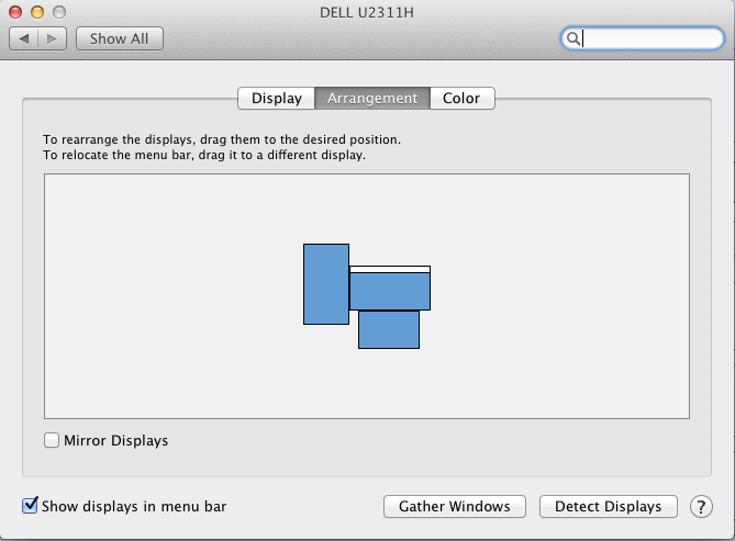

Well today I got my 3 display Macbook Air setup running.
MBA 13"/i7/2011/OSX 10.7.2
2 x Dell 2311H monitors
Plugabale USB Video adapter (Displaylink DL-195L chipset)
It works surprisingly well. I can basically pan between my MBA LCD and the 2 external Dell monitors running at 1920x1080.
The lag on the USB display is much less than I thought. I really only notice it if I'm running full screen 720p video or above.
Seems they've fixed most of the bugs with the latest DisplayLink OSX 10.7 driver.
One thing I did notice is that it's essential to connect the USB video adapter to the DVI input on the monitor instead of the VGA input, otherwise the text looks fuzzy.
macau is offline   0 Reply With Quote

Still really haven't had any issues with this USB video adapter. Works better than I expected.
Lag isn't noticeable unless I do full screen video or drag windows across the display very quickly. Non-fullscreen Youtube video is reasonably smooth.
Plenty of idle processing power as well.
I even managed to run one of the Dell monitors in Portrait Mode.
I reckon next year someone will create a dual thunderbolt adapter that will work with the Macbook Air. Until then this is probably the best solution.
