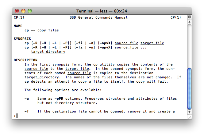

Code:
man cp
is the manual for the "cp" command. Enter that into Terminal and see this:

Thanks for the explanation. Honestly I don't understand the order and structure of the letters in the synopsis above and how can I apply it to my particular situation eg. copying an iTunes music folder in an unbootable disk0s2 to an external media eg. 500 gb LaCie via terminal from installation disc boot.
