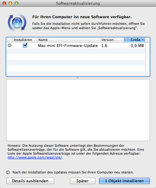

EFI Firmware Update 1.6 keeps re-appearing in Software Updates (Lion 10.7.3)
why does the latest Mac Mini EFI Firmware Update keep re-appearing in my software updates in Lion 10.7.3 on my Mac mini Server 2011.
i've tried installing it over and over again but it keeps appearing in the updates list. i also downloaded it manually at apple.com and installed it. it still keeps coming back in the list. is anyone else experiencing this? |

...same problem here...
Every time installing it, it leaves an entry in the installed software-log, but according to this: http://support.apple.com/kb/HT1237 the EFI 1.6 is not installed, yet (Boot-ROM-Version is "MM51.0075.B00" instead of "MM51.0077.B10") I even tried to download and install it manually - didn't help... While rebooting after install everything starts up just normal. Shouldn't there be some special progress-bar or so for actually updating the ERPOM? |

I run Windows 7 on the internal disk with MBR partitioning scheme. Am using an external RAID 1 (MBR) with OS X Lion for the odd occasion I need to do updates.
Had this same problem - it did not install. In my case it was because the internal disk was not formatted in GUID but MBR instead. I reformatted the internal disk to GUID and it installed happily afterwards. (PS It is not necessary to have OS X installed on the internal disk, I was able to boot from an external RAID1 (MBR). ) Afterwards I repartitioned the internal disk back to MBR and restored Windows 7. I suspect that on the odd occasion it can happen if you have a non-Apple SSD inside. |
