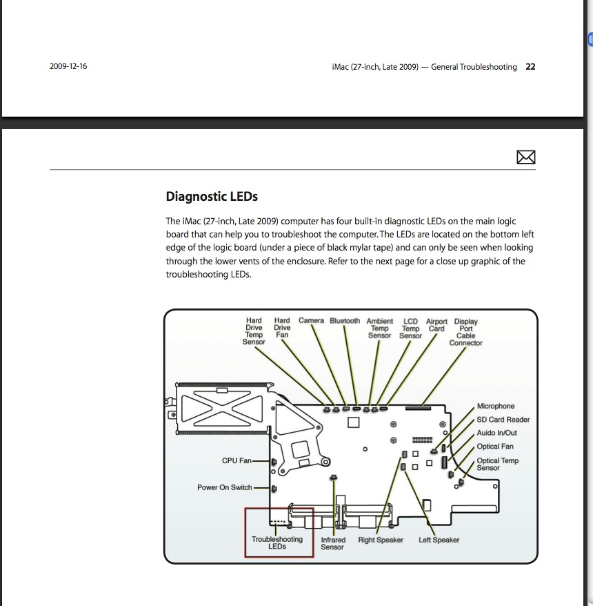

Whoever said that hasn't opened up an iMac, isn't an Apple tech, or hasn't read the service manuals. iMacs still have diagnostic LEDs, here's a screen shot from the late 2009 27" service manual that details the LEDs (Click to enlarge):

the 2009 iMac indeed has Diagnostic LEDs and there are 4 of them in the lower left of the logic board.
There is an area in the upper right area of the logic board below the GPU CPU bracket.
There are 14 pins.
7 6 5 4 3 2 1
14 13 12 11 10 9 8
Logic Board Test Point
Function
Pin 1
Ground
Pin 4
Standby 12V power (permanent power coming from power supply and present as long as AC cable is connected, even if computer is off); corresponds to LED #1
Pin 6
Backlight Control pulse width modulated signal (from logic board to LED backlight board, to adjust the backlight level setting according to user setup)
Pin 11
12V Run-Mode power to logic board (coming from power supply, present as long as system is on or asleep); corresponds to LED #2
Pin12
Power On Request signal (from logic board to power supply when power button is pressed)
Pin 13
Backlight Enable (signal from logic board to Backlight Controller board, to enable backlight
