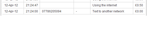

There are a few problems with the iMessage/FaceTime activation systems:
1) If you are on a "supported" carrier (or the phone thinks you are), then you won't be asked if it's ok to send the activation message (Apple has arrangements with "supported carriers" to not charge for the activation messages). If you're using an MVNO of a supported carrier (e.g. Virgin Mobile in the UK), then that means you might be charged for a message you weren't instructed about.
2) Sometimes the system glitches and the activation doesn't succeed. That means that it might resend the activation message (potentially at your expense)
3) Even if the activation succeeds, something might go wrong, causing it to reactivate the service(s). If this happens regularly, then the cost could add up. Some people report that it tries to reactivate every time they reboot their phone.
I swap SIMs occasionally, and that prompts a new message to be sent (see the attached picture).
