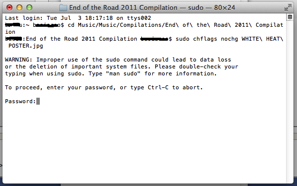

little bastard is being obstinate. Let's see if we can fix this with the command line. Fire up a terminal and type these commands:
Code:
cd Music/Music/Compilations/End\ of\ the\ Road\ 2011\ Compilation

I've typed in what you said and it has come up with this warning:
WARNING: Improper use of the sudo command could lead to data loss
or the deletion of important system files. Please double-check your
typing when using sudo. Type "man sudo" for more information.
To proceed, enter your password, or type Ctrl-C to abort.​
Is it okay to proceed?
Yes, it's ok to proceed.

Came back with this:
chflags: invalid flag: nochg​

My bad, the flag is "nouchg" (notice the added "u")
Hurray!
I corrected the mistake and the file in now unlocked 🙂
