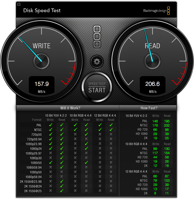

I have an early 2011 MBP I looked here: http://en.wikipedia.org/wiki/MacBook_Pro
says I should get 6GBs on my hard drive. I got a new ADATA SP900 and the speeds are horrid! I have attached the picture below ...
I should be getting somewhere around ...
Read : Up to 550MB/s
Write : Up to 505MB/s
I am not even getting half that ... I am getting 3Gbps speeds is the wiki link wrong on their info?

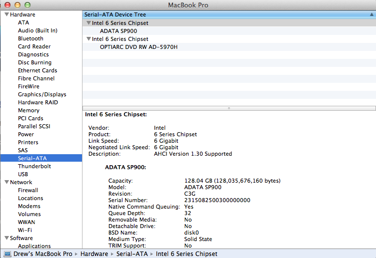

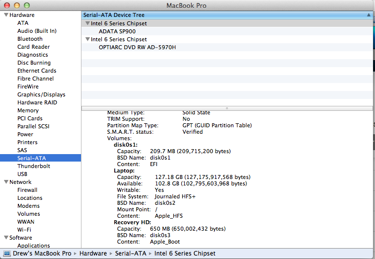

I looked at my hardware stuff ... it says it is 6g capable, but yet it wont produce it.
I looked for firmware on adata site and did not find any to download ...
any thoughts? 😕

Something's definitely wrong. My early 2011 had a vertex 3 ssd installed in the main SATA bay and I was getting the expected speeds...
Since you are negotiated at 6GB/s are you sure there isn't anything wrong with the SSD? Are you able to swap it out?

Forgive me if this answer is wrong;
I believe the problem is with the controller on the SSD, not the Mac. SandForce controller is used in the ADATA SSD you are inquiring about; the marketing material specifically notes the speed's using compressed information, this is causing the speed difference, as you are working with uncompressed data, it's a dirty marketing ploy.
( however I might be right out to lunch ) but this is what I gathered from some reading.
http://www.tomshardware.com/reviews/vertex-3-sandforce-ssd,2869-3.html
Above is an explanation about the controller compressing the uncompressed data before pushing though the "pipeline" if you are using compressed data already, the SSD skips this compression step and works that much faster.
I am running a Corsair Force GT 256 on my work provided early 2011 MBP. It is much better, but nothing like Samsung 830 on the my new 2012 MBP. 2011 early MBP getting 200 +- on the writes and 450 +- on the reads.
2012 MBP getting 390+- on the read and 495+- on the reads.

So then is it even worth having an SSD in there? I mean I was getting speeds just a little slower than that in my HDD I had in there before ...
You may just need to try flashing the firmware to find a version that works best for your Mac mate.
Personally I would skip over most SSD's in favour of the ones Samsung makes 830's are fabulous !
