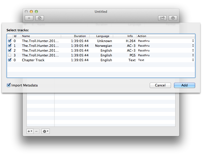

Sorry. Here is a screen shot:
I'm looking to make the Norweigan track and Subtitle track the default.
I'm also getting an error at the end of the conversion saying that it couldn't mux the subtitle track. I converted the subtitles to 3gpp txt and the error goes away but when i go to play the file and select english subtitles it doesn't play anything (and still no sound).

You NEED to have an AAC stereo track for the Apple TV to recognize that AC-3 track. The same will apply to the second AC-3 track you have there. Then you need to checkmark the main AAC track that you want to play by default and uncheck the rest.
As for the subtitles not showing up, check what "group" it's in. It should be on 2 by default, but make sure that the audio tracks aren't using this group or else you'll have conflicts.

File has non-text based subtitles which the aTV will not display. They either need to be burned in to the video track or converted to text based (srt) format which the aTV has the ability to play.

Based on the screenshot you posted, you have a PGS subtrack - that is, a native BD one.
You'll need to
a.)
1, convert it to VobSub
2, OCR it
OR
b.)
find an already-OCR'ed track in any of the online subtitle repositories - just make sure it's correctly synchronized.
For the former, you may want to check out post #22 and #23 at http://forums.macrumors.com/showthread.php?t=1469630
