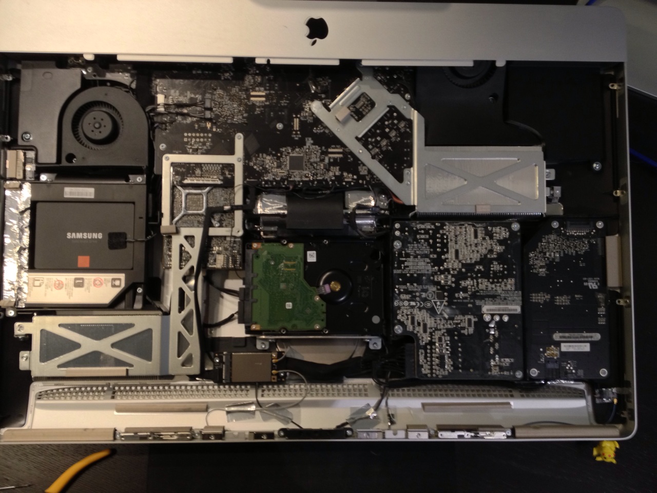

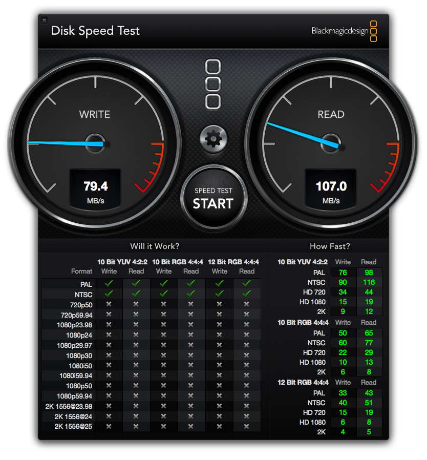

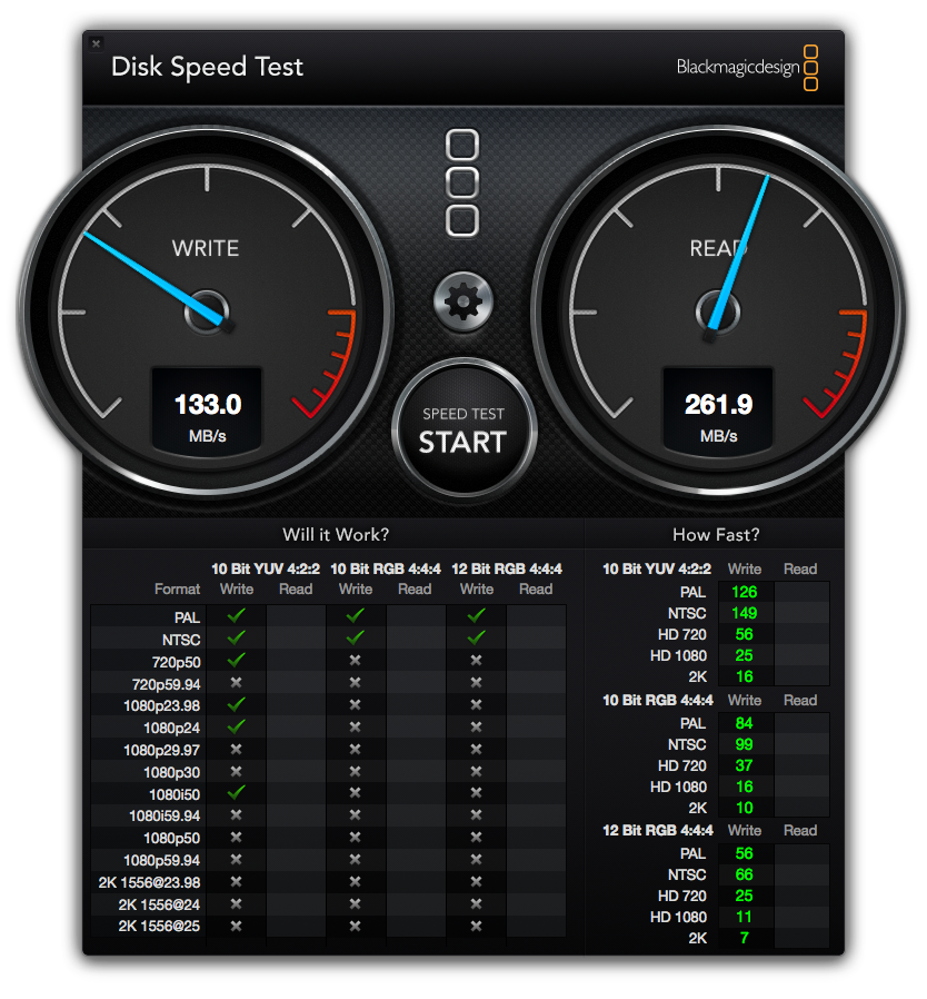

Well it's all in there. Results are as expected. Quite snappy 🙂
