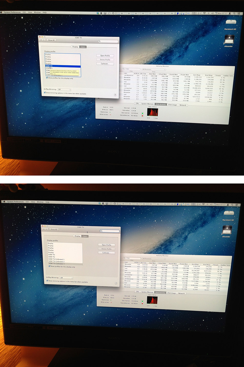

See attached image. The 2012 Mini definitely has an issue with the "crushed whites" but it is completely adjustable with just the built in Color Sync in System Preferences. See attached pic of my Sony TV hooked up to the Mini, look at the difference between the default color profile and the one that I adjusted myself.
