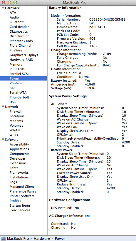

Hello everyone,
Please help me make sense of all these numbers and if I should be mindful of anything in particular about my two refurb 17" MBPs of late 2011 and 2.5Ghz quadcore i7 notebooks (recently arrived to me to test drive):
and
Are the numbers typical and in good over all levels or should I be concerned?
Thanks much!

please someone help me understand these numbers?
refer to my above previous post please, anyone? 😕
