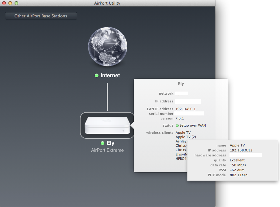

I just rechecked my airport settings and have my ATV connected at 150 Mbps. My second ATV that you see in the picture, however, is only connected at 65 mbps, but as it is further away from my router, I needed to connect it through the 2.4ghz band.
It is possible that the max speed for 2.4 Ghz is 65 mbps and the max for 5Ghz is 150mbps.
Here is a screenie!

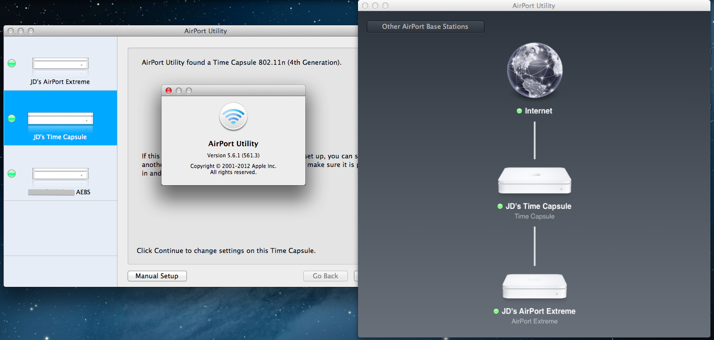

Airport Utility 5.6.1 will work on ML it just takes a tiny bit of work and by work I mean downloading an Automator Workflow and AU 5.6.1.
1. Go here to get Airport Utility 5.6.1 from Apple.
2. Go here and grab the workflow. This only extracts the Airport Utility app from the dmg file.
3. Drag the Airport Utility 5.6.1 dmg and drop it onto the Utility Extractor.
4. Wait a few seconds for the extractor to work and you will have the AU app.
I named mine "Older Airport Utility" since it has the same icon as the newer version and dropped it into the Utilities folder.
It will ask you to update the app each time you open it to version 6.1, just ignore that prompt and you can use the older version in ML.

I don't wanna hijack the thread but there seems to be a lot of knowledgeable people in here in regards to home networking. I just have one question.
When I go into the airport utility and see a list of devices connect to my airport express, I see that, for instance, my macbook has a connection speed of 130mbps. Then when I go and do a speed test I get a speed of 16mbps. How does this happen? Is the 130 just a hypothetical "max" connection speed and the 16mbps is what my actual connection is? I just wanna make sure I maximize my connection speed. Thanks
