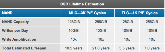

Is this really true? I thought S, M and TLC were just to do with write speed....can a 64GB Samsung 803 SDD really have a lesser lifetime than a 128GB?
Doesn't sound right to me but i could be wrong.
Yes that is true, TLC wear out faster than MLC, MLC wears faster than SLC.
Just a google picture which I found fast, but if you do some search you'll find out too.
Edit: the days are really short here, do some research, it is not as short as this.
Edit again: samsung-ssd-840-250gb-review, there is more info here.
And again: Go to page 4 first

Quote:
I'm not saying that TLC don't wear out faster than than MLC etc etc, but why would a 64GB be one type and a 128GB be another?
I.e if the 64GB is MLC, then surely the 128GB will be too. Storage capacity has no impact on write speed....does it?
The write speed of a 64GB SSD should thoretically be the same as a 1TB SSD from the same product line (i.e Samsung 803).
I'm not really understanding this to be honest, i might be missing something but it still doesn't make sense

Quote:
It's not about speed, the speed should be the same more or less, it is the amount of writes to the SSD, if you write the same amount of data to a 64 Gb SSD it would have half the life time from a 128GB SSD.
You should read that Anandtech article, it's the 840 though, but it gives you a start.
You can clearly see in the attachment in My last post the 128 has about half the lifetime of a 256.
