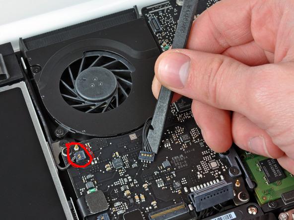

sorry for the late reply. There is ONE other cable that is very important.
I will let you know and possible upload a picture when home.
When I was replacing my CD drive I accidentally unplugged the cable and nothing would happen when I hit the power button. It is a tiny 2 prongged cable that comes from the top of the macbook.

Sorry about that. Check this cable, just nothing would happen when it was slightly unplugged.

Hi, the power adopter is working good bcuz I checked it another MBP, the problem is beyond understanding that when I disconnected the battery cable and reconnected it again what went wrong that MBP failed to power up?????????? it seems that some ic has gone off, I do not know exactly....
Quote:
the picture shows the red circle this connector relates to audio and where as the other is for fan,these connectors of my MBP are perfect because I did not touch it.
qaiser57 is offline   0 Reply With Quote
I know it is but the moment that is disconnected, nothing works lol. Double check the cable, even a little bit out and nothing will work.
Just walk through all the steps you did and re sit the HD you will probably find something you missed
