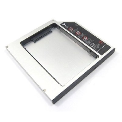

Given that your hard drive is probably 120-200GB, why don't you just replace it with a 256GB SSD?

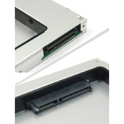

If you still need the HDD, you can then install it in an Optibay caddy with integrated SATA to IDE converter, but do not install the SSD in the Optibay because it would be really slowed down (it should be fast enough for the hard drive, though).

Thanks for this!! It took me a little while to figure out what the sam-heck you were talking about. LOL!
It never occurred to me to put the HDD in the DVD tray, and the SSD in the HDD cage.
Thanks a million!

I have a late 08 MBP which is similar in physical design to the Santa Rosa but has a Penyrn chip. The DVD slot is in the front and it's not a unibody. I did an ssd/hdd conversion last year using components from OWC and iFixit. Make real sure the optical bay caddy you get for the hdd is specific to the model number of your computer. The connector at the optical bay is PATA and requires a cage that convert to SATA for the hdd. I got mine from iFixit way before I started the project because they are hard to find. Ditto for the DVD drive if you are going to get an external enclosure for it. Make sure it has the same connection as the DVD in your machine. It's not regular SATA.

Just replaced my 500 GB 7200 hard drive in MacBook 3,1 with an 120 GB SSD from Kingston (V300) + 160 GB 5400 hard drive for a little storage. It was a really simple procedure, especially since i removed the Combo drive it shipped with years ago because it was faulty. I just slid the caddy into the empty space and secured it with two screws.
The caddy is from ebay, PATA-SATA, for 8,89 with free shipping.
