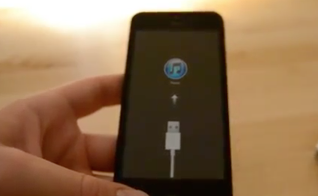

If the device is booting up again, you aren't putting it into DFU mode properly. It's a common mistake made, youtube a video and watch closely.
Open iTunes, plug it in. Turn device off completely. Hold power button for 3 seconds, then while still holding the power button, hold the home button for 10 seconds. After those 10 seconds, release the power button and keep holding the home button until the device shows up in iTunes BUT the screen stays off/remains black.
Do you have to release the home button immediately after you saw this
p/s : this only appeared for 1 sec after it boot me into Apple Logo. iTunes notify me my ipad is in recovery mode and restore needed on the same time.
What is the exact problem that cause Error 21? >.<
Again, I've never had to turn off an iDevice to get it into DFU mode. Pushing power button for 3 seconds then pressing home while keeping down power is a tricky maneuver, and in my experience, completely unnecessary. Just make sure the device is powered, which shoud happen automatically when you connect it to a computer. Then start from holding power and home down together.
And if you see the image of iTunes and cable, you let go too soon. Start again from the beginning.
