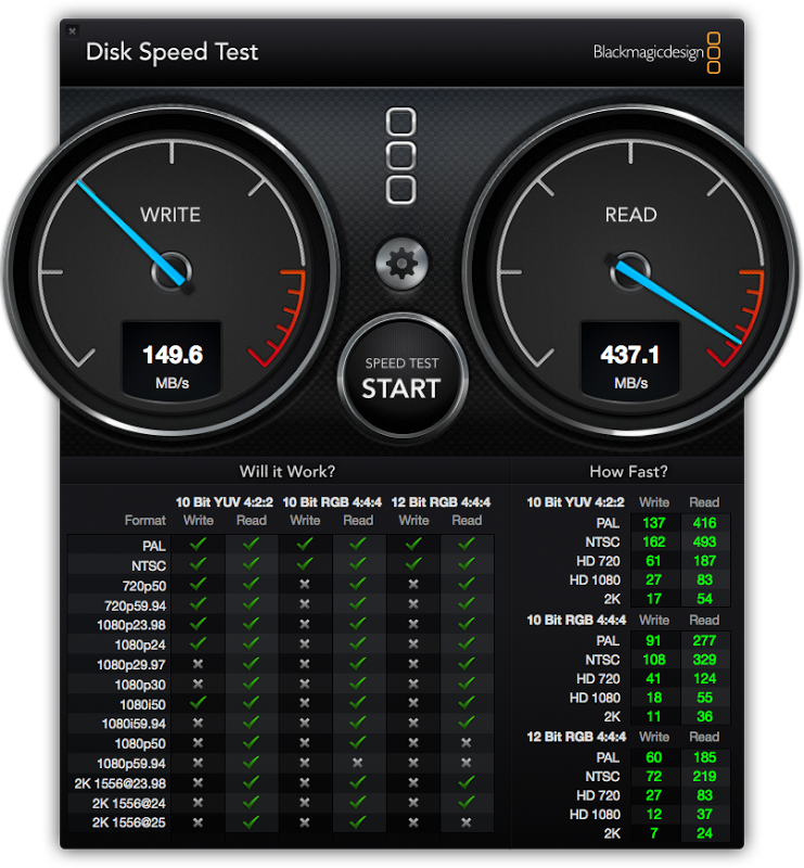

Hi, I re-started my computer again after the memory test and it again took a long time to start. I shut it down and re-install the OEM 4GB memory and re-start and it was still very slow. I decided to test the machine without an external USB HD that I have from my old PC, which holds some data I want to pass to the Mac Mini, and the machine started up really quickly. I then switched back to the new Corsair memory and it also went up pretty quickly, so seems that the issue is with that external drive.
I just run BlackMagic on the fusion drive and this is the result:
Is this good for a fusion drive?
Thanks,
Francisco

fskywalker is offline   0 Reply With Quote
