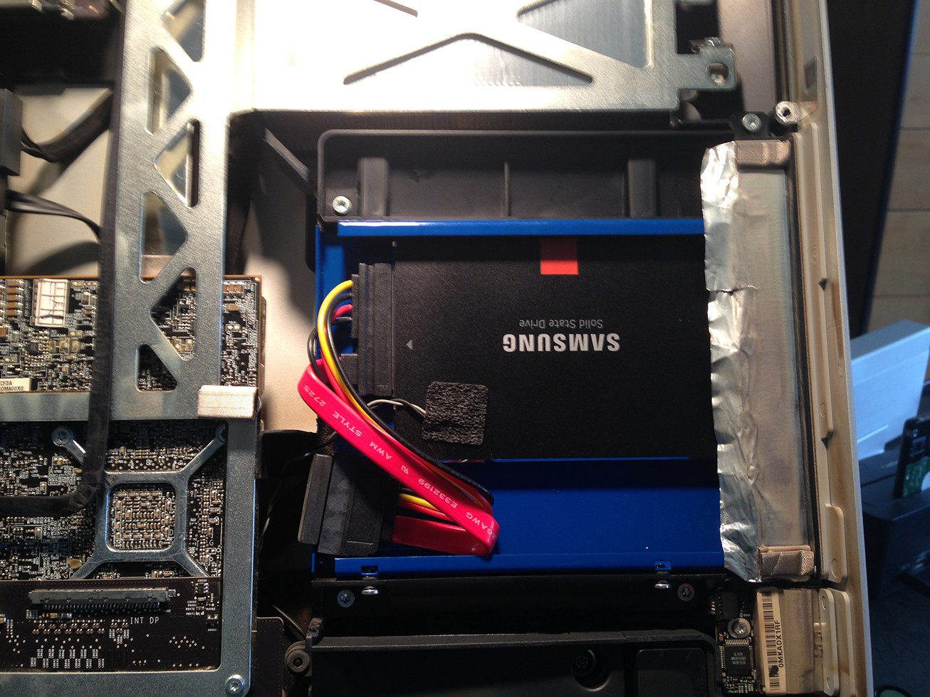

Just completed the install with the OWC tray (same one in your link) and a Samsung 840 (256)
on an 09 i7. The thing that slows me down is dealing with the tiny LCD cables. The wide ribbon on the right is a little hard to grab and release the side locks. It's so thin and delicate looking, I'm a little scared to really grab it. The small ribbon on the bottom left has a levered latch you have to pull back on it's top and then pull the cable down. It was a little sticky, but I took a break and got it done. The very top left cable you detach first is easy to lift out, but it's paper thin and short, so it doesn't have a positive feel when you put it back. My hands are perhaps large, so it's a matter of getting a feel while you hold the panel open. I worked with the iMac standing up.
I've worked with temp sensors before, so use a tiny object to slowly peel it and it's square cover away. The stick should remain if you go very slow & you can re-apply to the SSD. I didn't bother unplugging the temp cable. Just peeled it away before I removed the Optical.
I use an small hemostat to help with screws, but tweezers are fine.
The 840 works quite well. On the 09 I don't see the need to get anything faster.
I'll enable trim after re-filling some user files I removed for the install.
Good Luck

The caddy is nice, but designed for taller SSDs, It means you'll have to flex the cable right at the connection point on the SSD. I could have done a little surgery on the metal (bend it back and out of the way) but it works as is.
There are many discussions on using Terminal, or you can get http://www.groths.org/trim-enabler/ and turn it on/restart.
