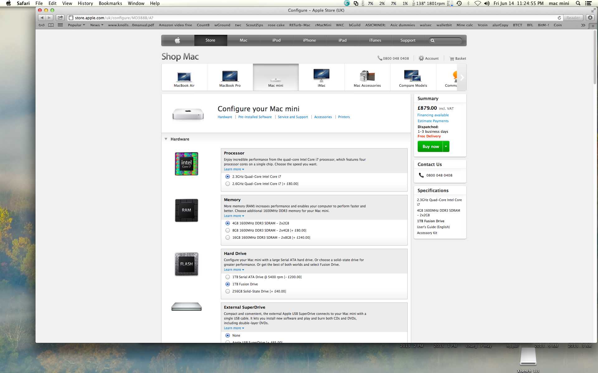

Since when does apple use a 256gb ssd in a mac mini as a fusion option? I am looking at the usa store and only see a 128gb ssd with a 1tb hdd. Here is a screen shot of the uk fusion and it is not with a 256gb ssd.
Although the genius should know this fact. "The apple mac mini fusion is a 128gb ssd with a 1tb hdd."
So I do not think you are defrauding him. I just would think they are being nice to you.

Sorry. didn't word it properly. What I meant was the same model of SSD only mine was a 256gb and you are correct that apple only use a 128gb.
When the technician opens it up there's a chance he won't notice the size difference as in my experience with apple, not all are the experts that they make themselves out to be.
