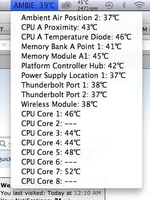

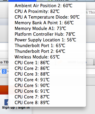

Very hot day, new mini gets very hot
Don't believe me, check the attatched! I had to manually speed the fan up to 5500 to get the temps down.
Truly wonder why Apple did not speed them up???
Glad I remembered smcfancontrol from these forums. Does just what I want. Min is now 3600 RPM
It is still silent. I LOVE that. I REQUIRE that.

I care about noise AND heat. That is why I went right out and got Temperature Control software. It runs in the low 40's to low 60's now
But everyone has said the high temps are normal, and they have much more experience with the mini than I.
See below. And it is a very hot day

Sadly the temp performance you see is totally normal.
The fans will not increase until the processor reaches 90 to 95degC - by design. At that point it will regulate the CPU temp to be ~95degC - by design.
Expect a loading of 20% to 25% to get your mini to this state. Above 35% load expect fans at maximum.
All by design. A great thermal design? Not in my opinion. Within spec? Sure - running at 90% to 95% of the thermal limit (105degC). Will it last 3 years like this? Probably -- maybe not -- no one knows :-). Apple care only goes three years - I would not expect more for a heavily used machine... just my opinoin though :-)

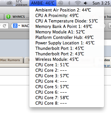

HERE IS ANOTHER GRAPHIC. THE FAN SPEED IS AT THE MIN SET BY ME.
It is about 95 degrees with no ac in room. Do have a small fan though.
Also, does it strike anyone else as a bit well, stupid, for Apple not to put proper paste on at the factory? I mean really about like 2% of users are capable of doing this and it just makes plain old good sense to do it.

Even though I am a 'paste changer', to be fair, Apple's thermal paste is ok. It is just not premium stuff. Also they are not consistent with the type of paste. The main problem is the application. They tend to slap it on like its a peanut butter sandwich.
Even though I am an advocate of Tuniq TX-4 and Article Silver 5, I would not recommend changing the paste unless you know the inside of a mini quite well and know the risks of breakage. As a few other forum members have noted, AS5 is not the best for the mini because the heat sink does not fit well. Tuniq is thicker and better for the mini.
oh okay. I didn't know that first pic was a "before" pic
__________________

Cape Dave
Thread Starter
macrumors 6502a
Join Date: Nov 2012
Location: Northeast
Quote:
LOL!, Yup! The heatwave is breaking a bit here. Was so good to be in charge of my temps!
