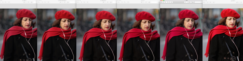

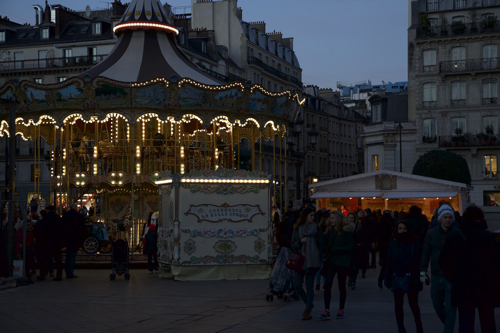

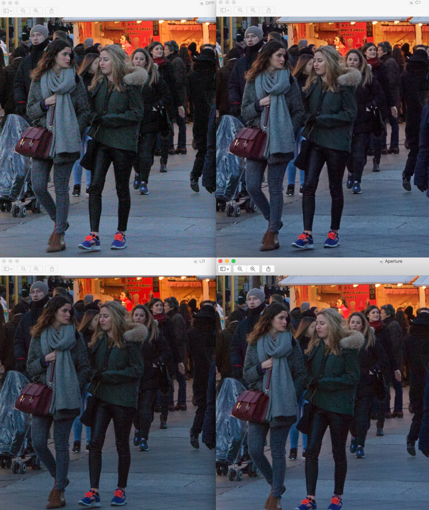

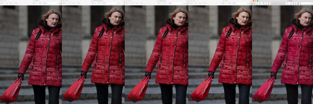

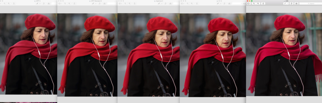

I've been evaluating Capture One Pro over the past few days as a possible Aperture replacement. The more time I spend with it, the more I like it and feel it's actually an upgrade rather than a replacement.
One thing I noticed when I was playing around with C1 was the difference in how it rendered RAW images, particularly with red tones.
This morning I actually spent a few minutes evaluating DPP, C1, Aperture, and LR5 RAW conversion with a few recent photos from Paris that had some serious red tones in them. No adjustments were applied to any of the images.
Notes:
- The app used is in the title bar of each image... from Left to Right: DPP (Faithful), DPP (Standard), Aperture, C1, LR
- DPP is Canon's software, so ought to reproduce the RAW file the most accurately of the bunch. I used the "Faithful" picture setting for the first image in each series which offers no adjustment, and then used the "Standard" picture setting for the second image in each series which shows how Canon likes to render their JPEG images for reference.
Comments (to my eyes):
- Aperture is significantly more saturated than the DPP Faithful or Standard but a bit towards orange
- C1 is less saturated and offers slightly better contrast and detail (see the design on the coat in the 2nd series) - it looks great in the shade, but I don't like the look in the sun
- In the two shade shots, Aperture and C1 look closest to Canon's standard JPEG setting
- LR is saturated to a similar extent as Aperture but towards magenta to the point it almost looks a bit purple
- Most people probably wouldn't know the tones were off except in a side-by-side comparison.
- I'm actually amazed at how much different there is between RAW conversions.
Here's the results. Click through for larger sizes...
Shot 1 by Virtual.Rain, on Flickr
Shot 2 by Virtual.Rain, on Flickr
Shot 3 by Virtual.Rain, on Flickr
I'll do some more comparisons later in the weekend if I get some time.
(EDIT: Updated the images to include a DPP RAW rendered in both "Faithful" and "Standard" picture mode)

I think C1 does the best job out of the box, that is importing an image and hitting the auto adjust button.
That said, Aperture and LR can come pretty close what C1 does, as long as you take the time to work on each image. Aperture does the worst in noise reduction, and C1 does the best imo in pulling out detail from blown highlights.
Agreed. I think you could make any of these look like the other, but the RAW converter that gets you closest to what you want out of the initial conversion is the one that will save you the most time in the long run.
I'll have to look at pulling shadows and noise as part of this evaluation too.
maflynn
macrumors Haswell
May 3, 2009
73,419
43,306
No argument there. For me, in my research that was C1, hands down. What I had trouble with, was the UI and DAM. Since I'd be using the app quite often, if I can't easily make it work, then that is a problem.

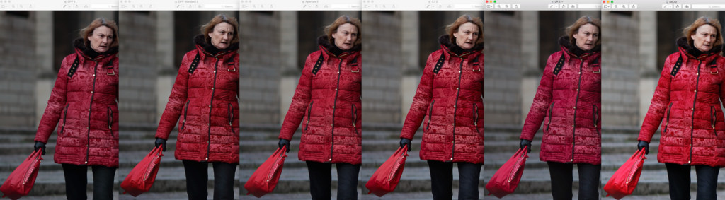

In this comparison, I lifted the shadows on this underexposed photo...
5DM32746 by Virtual.Rain, on Flickr
It's hardly a scientific test as you can recover shadows in a variety of ways (exposure, black levels, shadows, etc.) and I typically used a combination of all three here where possible to try and achieve a similar result. Noise reduction was not used (I actually had to turn it off in DPP as it applies overly aggressive NR as a default).
Here's some 100% crops of the lower right after shadow recovery. (Click through for bigger sizes)
Shadow Noise Compared by Virtual.Rain, on Flickr
C1's noise looks fairly good... You could probably use this without further adjustment at web sizes and it's NR tool will allow you to clean it a little bit more. LR looks pretty noisy, but thanks to it's superior NR tools, you can clean this up completely in a jiffy. Aperture is pretty noisy and as everyone knows, there's not much you can do to clean this up in Aperture.

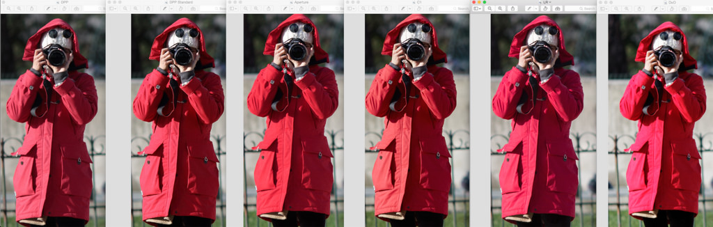

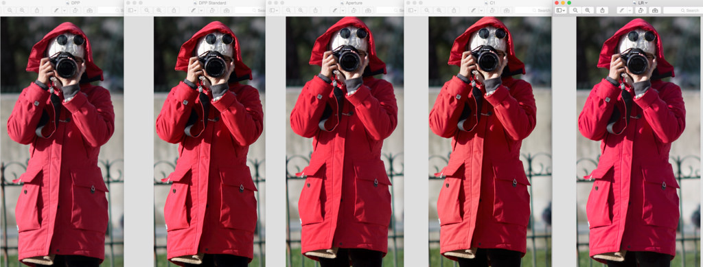

T
... I moved to DxO, and found I liked their default processing but was especially wowed by the dehaze tool; it's amazing. But probably useless with portraits.
So I looked at the default RAW conversion in DxO for the same images as I used above which emphasis red tones which seem to be the toughest for RAW converters to handle. (DxO is the right most image)
As you can see, DxO produces the most saturated images with the one in the sunlight not being very attractive at all.
Click through for larger versions...

This is very helpful. Thanks for doing it. I have read in other places that C1>Aperture>LR for raw conversion out of the box, but hadn't seen DXO added to the mix. Also, I have read that LR has been improving lately.
As Apple is claiming better RAW in the native OS (and thus Photos), it will be interesting to see how that looks. And they mention better noise reduction specifically.
maflynn
macrumors Haswell
May 3, 2009
73,419
43,306
I found Aperture (and thus Photos) to be close to LR in my experience. Thanks to LR's tool set you can pull more out of an image and clean it up better.
I've just started comparing DX0 and LR, I think I started this last year but I'm re-looking again. So far for me, I'm content with LR's RAW handling.
