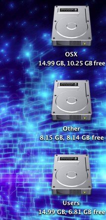

check this...after reformatting a week or so ago, this is what I ended up doing...OS9 might go on the Other partition if I decided I need it after all...the Users partition is actually mounted at /Users instead of the default /Volumes/Users so the Users folder on the OSX partition is the Users partition as you will see in the following post...and the "other" partition can always be used if the Users runs out of space or something..
