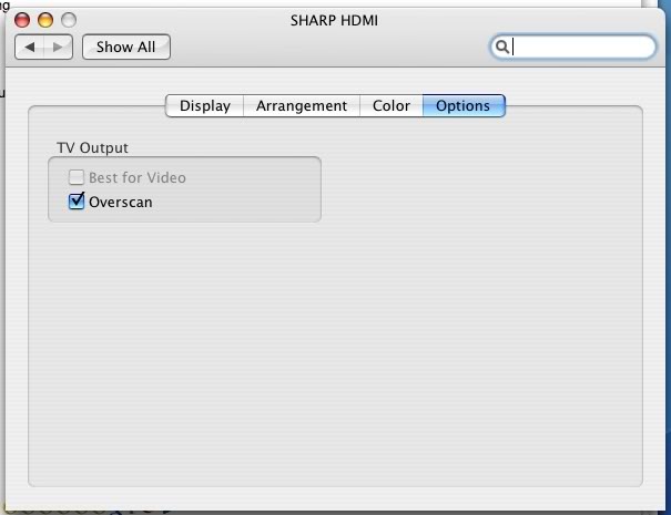

As for the TV issue, what model TV do you have? Is the TV capable of 1080p with no overscan (aka 1:1 pixel mapping; dot-by-dot)?
Have you tried messing with the settings in the Display System Preferences? There's a check box for overscan.

Anyways, overscan is a by product of analog TV broadcast and CRT TVs. Basically, overscan is when you have portions of the TV broadcast that is not shown on the screen. Typically, with analog TV, the overscan is about 5%. What that means is that 5% of the TV picture is not shown on the screen and everything else is zoomed in to fill your TV screen. It's annoying, but it's been that way from the beginning. And the producers know this and make sure that nothing important is on the outside 5% of the screen.
With digital TVs, there's no need for overscan since digital TV's can display the exact broadcast pixel in the exact display pixel location. Meaning that the pixel that is located at coordinates 17x22 is displayed at the right location on the screen. So it's easy, right? Well no, since for whatever reason, many digital TV makers still build in overscan. I don't know why.
In any case, if your TV can do 1:1 pixel mapping, then you should select that and make sure the Overscan box IS NOT checked. On my Sharp 62U TV, 1:1 pixel mapping is selected by using the "dot by dot" zoom setting.
If your TV can't do 1:1 mapping, you may want to check the Overscan box.
Reading your description, I suspect that your TV is capable of 1:1 and that the Overscan box IS checked off. Try unchecking first.

You have to have the TV connected. Go to the Displays System Pref and click on the "Options" tab.

I'll check again, but when I last looked I didn't have that option... or acctually I never had "option" as an option
UPDATE: No option button... is that my tv's fault?

BTW, I think I may have been mistaken in one of my previous emails. For the record, the overscan box is checked off in my set-up and the TV is set for "dot-by-dot". It produces a full 1920x1080 screen that fills up the entire TV (except for the very bottom row of pixels - I've read that it's a bug on the Sharp TV, but I don't even notice one line of pixels, so it doesn't matter).
