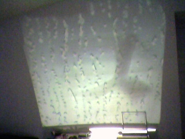

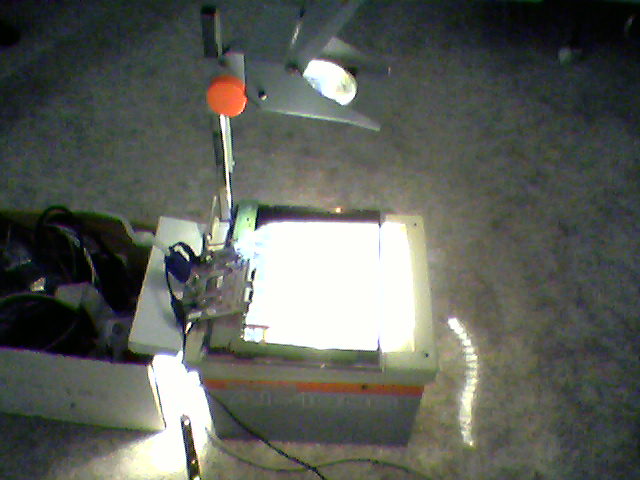

I converted my 15" LCD into a projector
So I had decided to turn my 15" LCD into an overhead projector a couple months ago and finally got myself to do it. Let me just say that taking apart LCDs is not fun... I'm sorry I don't have pictures of me doing it, it didn't come to my mind, and it probably would've made you even more surprised that it still works .
The first thing that I did was to open the LCD, obviously. I used a Compaq 1501 LCD, it was actually very simple to do it, there were two slots at the bottom of the LCD (After you unscrew the bottom stand) where you insert a flat screwdriver and pry it open. After that you go through unscrewing millions of screws and by millions I mean over fifty. The hardest part was when two screws refused to come out, so lets just say that I cut a bit of metal with an exacto knife (Only thing I had on hand, and it took over an hour to do that). After unscrewing all the screws I came to all the circuitry which I carefully took out (really, I did do it carefully) and placed next to the LCD while the backlight was still in place. Next I took apart the metal that was holding the backlight to the LCD and took out the LCD. I then took the metal without the backlight in it and placed the LCD in a position where it would not be scratched and reassembled the circuitry to the LCD and placed on the overhead projector I own. I turned it on and it works, which is very surprising considering this is my first mod and it was fairly complicated considering that I had never done anything like it before. It does work very well and does not overheat (I've had it one for about 3 and a half hours and it's been fine), there is a 20" box-fan on high cooling the LCD down. I took some pictures of the end product using my cameraphone. (The first picture shows the size comparison between the original 15" casing and the size of the screen I'm using with it now, the casing is in the lower right.)
The mod took about four hours, which mostly went to taking the LCD apart. The cost of the components was as follows:
15" LCD - Free (Relative upgraded to a 19" and gave their old one to me)
LCD Power Brick - $20 (Unfortunetly it did not come with the power brick)
Overhead Projector - Free (My dad is a teacher and they upgraded to a better overhead projector. I still want to get a better one though, it's a bit dark.)
4 hours of my time - priceless (Come on, it was asking to be said )

The overhead projector I'm using isn't very good, so it's actually not very good image quality, but it's fine for watching video, which is what I'm going to use it for. I'll eventually get a better overhead projector for it, but for now it's fine. The text is not very legible in the one darkish area that you can see in the picture, but it's fine for the rest of it.
Quote:
Originally Posted by NickD View Post
Neat idea. I can't wait for some better photos (cameraphone?). Please post some new pics soon!
Yeah, it's my Samsung Cameraphone that was used to take the pictures. I'll see if I can use my parent's digital camera tomorrow to take more pictures.
I forgot to say that the screen is projecting it at 101 inches, so it is about an 8 foot 5 inch screen right now.

I reassembled the LCD Casing minus the Panel, electronics and the metal part the Panel and the Backlight were attached to, so I could post step by step instructions on how I took apart the LCD (From memory, so if I made a mistake I'm sorry). (Some of the pictures are links so as to not go over the 10 image limit)
First I unscrewed all the screws on the bottom stand and took the bottom stand off.
Next there were two slight gaps in the bottom of the LCD casing where I inserted a flathead screwdriver and pried it open.
After that I lifted off the back part of the LCD Casing and I was left with the metal inners of the Case. I unscrewed all of the screws attaching the lighter metal casing to the heavier metal casing. (Two of the screws stuck so I used some wire cutters and an exacto knife to cut around them so I could disassemble it). There were some electronic boards attached to the lighter metal casing, so I unscrewed all of them to take apart the casing. (Be sure to unscrew the two VGA screws)
Next I unscrewed the screws attaching the heavier metal casing to the front plastic.
http://img151.imageshack.us/img151/4344/pict0043oh8.jpg
http://img412.imageshack.us/img412/3170/pict0044uc9.jpg
http://img151.imageshack.us/img151/3233/pict0045ga4.jpg
With the heavier metal casing disassembled I unscrewed several screws on the side of the heavier metal casing which attached it to the metal holding the backlight and panel together. And then I unscrewed the screws holding the metal holding the backlight and panel together.(Sorry I couldn't get a good shot of this.)
http://img227.imageshack.us/img227/1156/pict0047kl9.jpg
After that I carefully lifted the Panel from the backlight and set it back on the metal that was holding the Panel and Backlight together in a position where it would not be scratched. After that I reassembled the circuitry that makes the LCD work and set all that on the overhead projector that I have (Mine is an Apollo AL-1000).
http://img96.imageshack.us/img96/7347/pict0051kb9.jpg
There are three problems with the projector though. One of the problems is that the projector does not project all of the 15" LCD, only part of it. (Albeit the major majority of it) Secondly is that the circuitry has to hang over the Panel in order for it to work so it obstructs the projector from projecting a bit more of the LCD. And Third is that the overhead projector itself has a spot where it is darker than the rest of it and it gets annoying when you are looking at light backgrounds and even during normal usage.
(The silver line shows how much of the LCD should be shown and what is obstructed by the circuitry)
http://img187.imageshack.us/img187/4471/pict0055td7.jpg
http://img139.imageshack.us/img139/5705/pict0056wm5.jpg
