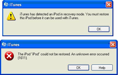

I'm not as lucky 😡
I attempted the same process "RESTORE IPHONE".
It went thru step 7, I selected to recover. It took a long while telling me that it's preparing, then eventually it failed with dialog saying "...iPod could not be restored..."
See attached images.
I probably will try the second method DFU. Btw, what does DFU stand for?

This May Help

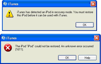

I'm not as lucky 😡
Sorry if you already fixed it, but just wanting to help other people in need to complete this post.
DFU means "Device Firmware Update" which lets Apple to restore any phone to a clean, factory setting phone with any firmware required. This is used worldwide to jailbreak an iPhone or an iPod Touch.
When it said that "iPhone could not be restored", that meant that iTunes is not capable to handle that software (firmware) on your iPhone. I restored my friend's iPod Touch at school to OS3.0 and with iTunes 7.5. It kept cancelling the restore at "Verifying iPod Software" because it does not have the newest drivers that is capable to run the new firmware.
If your iPhone was restored to, let's say, 2.2.1, on the same iTunes, then your iPhone software is corrupted. You would have to use the DFU mode restore to fix your iPhone. But it is mostly recommended that you update your iTunes to the latest. If you jailbroke, then you should stick with iTunes 8.2 beta because it is capable with Jailbreaking applications and is compatible with the new iPhone OS3.0
Hmm...I dunno. When I had that error (except that the code was 6 or 13 instead of 1611), I made an appointment with the Genius Bar and they replaced my iPhone. They mumbled something about flash memory probably having gone bad. But mine got past "Verifying iPhone Software" and kept failing at "Installing iPhone Firmware".
