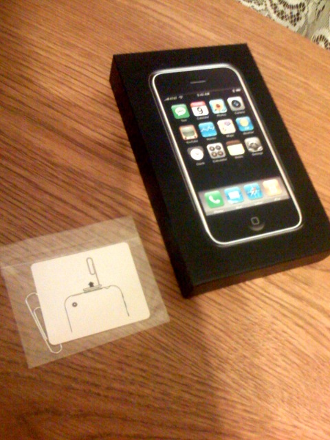

Just wondering, when you get a "new" iPhone as a replacement from apple, do you get it in a new sealed retail box with eveything?
If so, thats impressive.
It came in a new box, a lower-profile box than the original retail purchase, because it does not have the dock, power cord, headphones, etc. Just the iPhone in a very flat but nice box with the same photo of the iPhone on the cover.
The only included "accessory" is a nicely wrapped Apple-approved paper clip with a nice diagram of how to utilize it to remove the SIM card. I wasn't really paying attention at the genius bar when I picked up my "repair." The genius took it out of the package, swapped the SIM card from the loaner, and tested out the phone for me. He handed me the phone and I started to walk off and he said "Don't forget your box" which I hadn't even noticed, and thought "Wow, how cool I get such a nice box for getting my phone repaired." So I don't know how "newly wrapped" it was, and didn't even realize it was a new phone altogether until I got home and couldn't get on my wifi because it had a different MAC address. Then I read the paperwork and saw where I had gotten a replacement.
