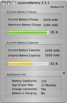

Anyone have an idea of what constitutes a "low charge capacity/runtime?" I just calibrated my battery and it is at 61% health after 133 cycles. If gives me anywhere from 1:45 minutes to 2:15 minutes of run time.

I would take it in. I think the rule of thumb is something like 80% after one year or 300 charges or something like that.
Mine went down to 71% after 15 cycles (which in reality was more like about 5 or 6 actual cycles). I did not hang around any further and got it replaced.
