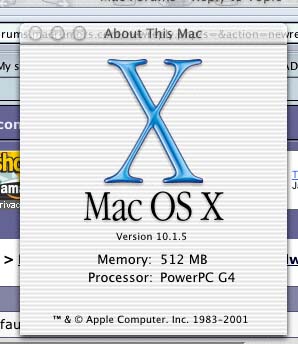

i think you should state more info on your machine,whats in it what you run and what made this happen, i had a very similar experience one time with a lightning strike. turns out my ethernet card was burned up and gave me similar issues. anyways put out the details of your quicksilver.
lastest work order and some info
I'm not to sure what is on the inside as far as cards and stuff- Its basically used for Photoshop and Internet and iPhoto. It's got a dvd burner and...? I'm pretty stupid about the inner workings. Is there a list of things maybe I can ask the dealer on Tues.,(Labour Day holiday on Monday) about?😉
