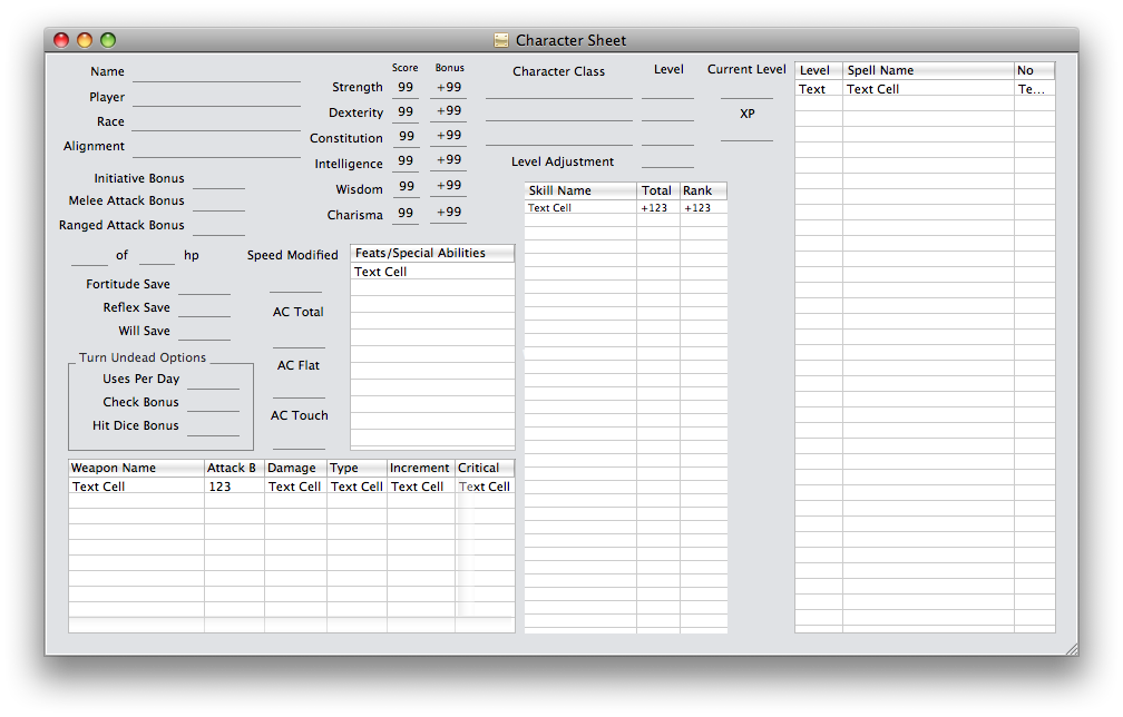

I have been trying to add printing to D&D Manager, so that you can print off information about the characters. I have created a view for printing, which seems to print fine except that half my labels are in the wrong place. The first attachment is the view in Interface Builder, and the second is the PDF "print".
The Image from IB:
The Output:
View attachment PDF Output.pdf

I didn't download the project, but the only reason I can think of that the form fields would be moving is because the autoresizing masks haven't been properly setup?
That looks like the reason, they are different for the different elements, and given the new IB I didn't notice. Thanks 😱.
